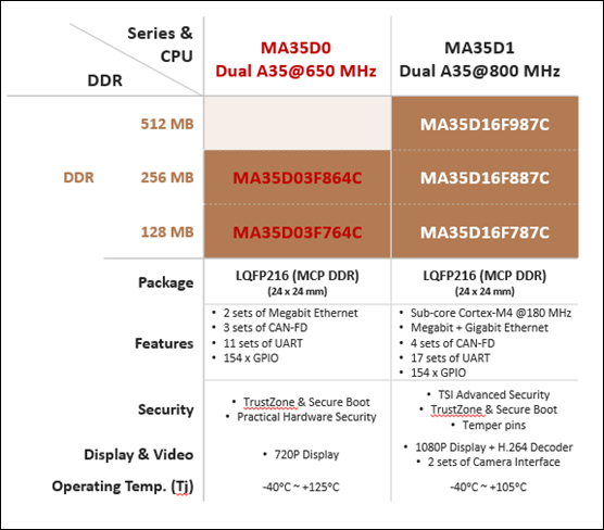

The MA35D0 series fits just below the MA35D1 series in Nuvoton’s product lineup.
MA35B0 product line compared to MA35D1
MA35B0 product line compared to MA35D1. Image used courtesy of Nuvoton
It is powered by dual 64/32-bit Arm Cortex-A35 cores at up to 650 MHz.  Each core has 32/32 KB I/D of L1 cache and 512 KB of shared L2 cache. The MPUs contain a 128 KB internal boot ROM and can boot from USB, SD/eMMC, NAND, and SPI Flash (SPI NOR/SPI NAND).
The series includes two parts (datasheet linked): the MA35D03F864C with 256 MB of DDR and the MA35D03F764C with 128 MB of DDR. Both come in a 24 mm x 24 mm, 216-pin LQFP package with 154 GPIO. The chips are industrial temperature rated for operation from -40°C to 125°C. To keep the package size down, the MPUs use internal stacked DDR SDRAM. The 3F764C uses DDR2, and the 3F864C has higher capacity and faster DDR3L.

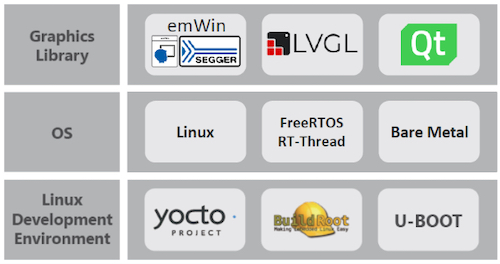

Nuvoton provides a full-featured ecosystem for its MPUs, including the new MA35D0. The product line supports multiple operating systems or can be run “bare metal” for microcontroller-like operations that need the lowest overhead.
Nuvoton MA53D0 ecosystem
Nuvoton MA53D0 ecosystem. Image used courtesy of Nuvoton

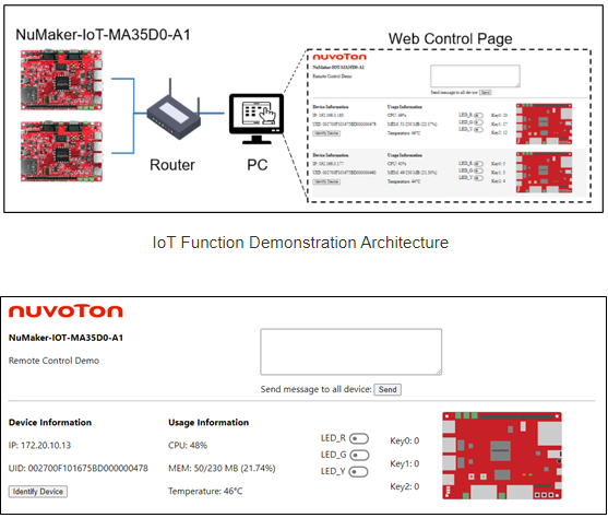

Along with the MPUs, Nuvoton introduced a full-featured evaluation board. The NuMaker-IoT-MA35D0-A1 comes pre-loaded with remote control examples, including cloud connectivity and browser-based status and control, and board-to-board communications examples.
NuMaker-IoT-MA35D0-A1 evaluation board.
Web demonstration set for NuMaker-IoT-MA35D0-A1 evaluation board. Image used courtesy of Nuvoton
