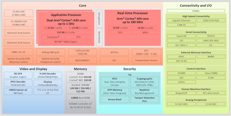

Nuvoton MPUs place more emphasis on computing
Compared to microcontrollers, the Nuvoton MPUs place more emphasis on computing and processing power than peripherals, allowing them to target different applications. (Click image to enlarge)
Compared to a humble Arduino or other MCUs, the MA35H0 series of MPUs sports more raw computing power for more advanced applications. Even so, the devices integrate fewer peripherals on a chip, requiring more board space and BOM cost to control external components. This tradeoff makes the MPUs better for compute-heavy applications.
