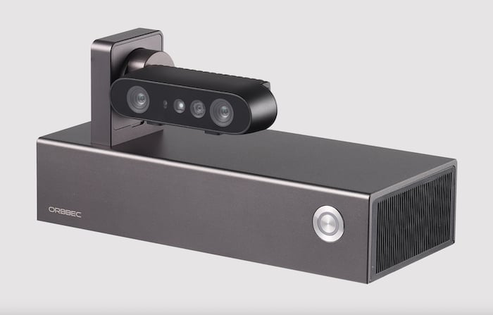

Front view of the Persee N1
Front view of the Persee N1. Image used courtesy of Orbbec
The Persee N1
The Persee N1 is an all-in-one camera-computer kit designed for 3D vision applications. The module consists of two major components: a computing platform and a depth camera.
The core of the Persee N1 is the Nvidia Jetson Nano platform. This platform consists of a Quad-Core Arm A57 processor, clocked at 1.43 GHz, along with a 128-core Nvidia Maxwell architecture GPU. Together, these resources yield an AI performance of 472 GFLOPS.
The camera component of the Persee N1 is Orbbec’s Gemini 2 camera, based on active stereo IR technology. This technology, combined with Orbbec’s custom ASIC, ensures high-quality depth processing. The depth camera offers a wide field of view (H91 degrees x V66 degrees) and a depth range of 0.15–10 meters. It can also deliver a depth resolution of up to 30 frames per second at 1280 x 800 and an RGB resolution of 1920 x 1080.
Furthermore, the device supports multi-camera synchronization and includes an inertial measurement unit (IMU), enhancing its capabilities for complex applications. The Persee N1 operates effectively in indoor and semi-outdoor environments, with an operational temperature range of 0°C to 40°C.
Orbbec developed the Persee N1 system for medtech, dimensioning, interactive gaming, and robotics applications.
