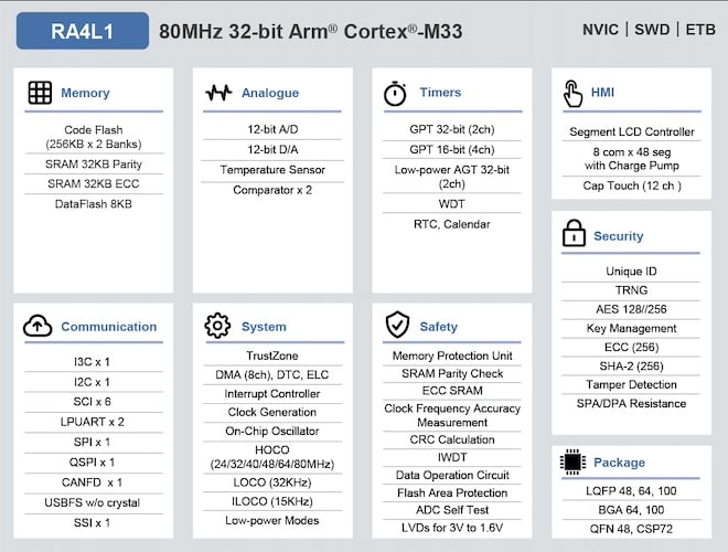

The RA4L1 microcontroller series integrates an Arm Cortex-M33 core with TrustZone support, operating at up to 80 MHz. It features up to 512 KB of Flash memory, 64 KB of SRAM, and 8 KB of data Flash rated for 100,000 program/erase cycles. To support the memory hierarchy, the system has a built-in memory protection unit that defines eight secure and non-secure memory regions.
For connectivity, the MCU family supports a range of communication interfaces, including six serial communication interfaces for UART, SPI, I2C, I3C, LIN, and Manchester encoding. A USB 2.0 full-speed module, a CAN FD controller, and a quad-SPI interface provide additional connectivity for high-speed data transfer and external Flash expansion.
Block diagram of the RA4L1
Block diagram of the RA4L1. Image used courtesy of Renesas
The microcontroller’s analog subsystem features a 12-bit ADC with up to 16 input channels, a 12-bit DAC, and dual low-power analog comparators. An integrated temperature sensor enables real-time thermal monitoring, while the timing system includes two 32-bit general-purpose timers, four 16-bit PWM timers, and two low-power asynchronous timers.
Security features include Renesas' Secure IP (RSIP-E11A) for AES and ECC encryption, SHA-256 hashing, and device authentication via a 128-bit unique ID. TrustZone memory segmentation protects Flash and SRAM, while lifecycle management and tamper detection enhance system integrity.
Finally, the power management system supports multiple low-power modes that can reduce standby current to as low as 1.65 µA. The microcontroller nominally operates between 1.6 V and 3.6 V and includes a real-time clock with calendar functionality. Other notable features include an integrated capacitive touch sensing unit, an LCD segment controller, multiple clock sources, and PLL-based frequency scaling.
