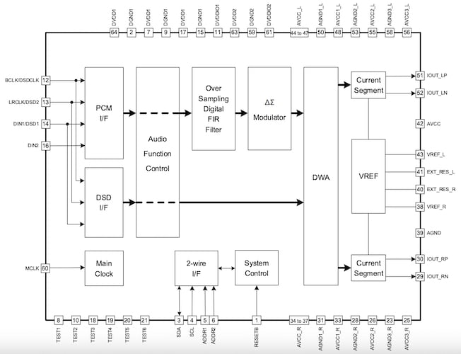

Functional block diagram of the BD34302EKV
Functional block diagram of the BD34302EKV.
The BD34302EKV includes other features found in a flagship DAC chip. It operates on a two-wire interface for register settings. It supports both PCM and DSD audio formats. In PCM mode, it supports sampling frequencies from 32 kHz to 1,536 kHz, an improvement from the first generation IC’s frequencies from 32 kHz to 768 kHz. Users can select between two digital FIR filters in PCM mode for more noise control. The DSD clock supports operation at 2.8/5.6/11.2/22.5 MHz. The DAC supports up to two channels at 32-bit resolution for additional audio precision.
