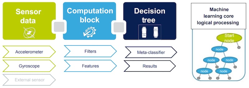

The LSM6DSV320X’s machine learning core
The LSM6DSV320X’s machine learning core can be configured to run up to eight decision trees simultaneously, with each tree yielding up to 16 results.
For more advanced applications, the sensor includes a Machine Learning Core (MLC) and a Finite State Machine (FSM) that allow it to run AI inference locally. That means it can detect context, such as recognizing a fall or a rapid tilt, without constantly pinging the main processor. This saves battery life and frees up system resources. Additionally, developers can take advantage of ST’s patented Motion XLF library, which merges data from both accelerometers to deliver cleaner, more reliable readings even under intense movement.

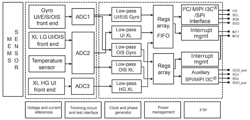

Block diagram of the LSM6DSV320X's filters
Block diagram of the LSM6DSV320X's filters.
With this feature, the sensor always operates in the most power-efficient mode without user intervention. If someone wearing a fitness tracker suddenly goes from walking to sprinting or takes a tumble while rock climbing, the sensor can respond instantly, dialing up the sensitivity or shifting modes without draining the battery or waiting for instructions from the main CPU.
