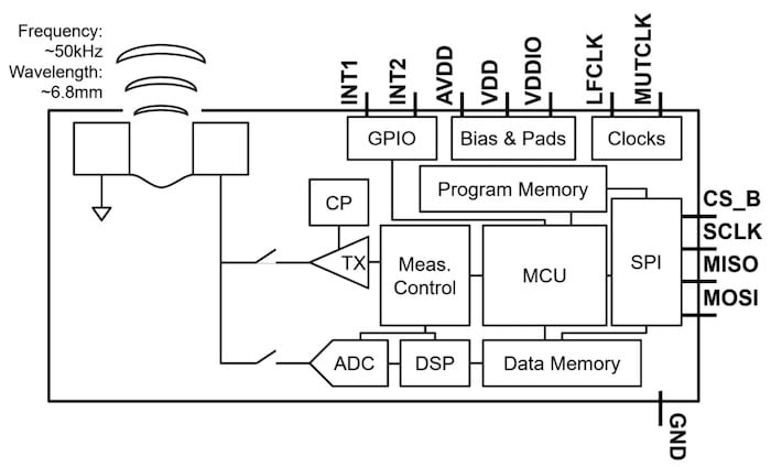

The new SmartSonic ICU-30201 ultrasonic sensor delivers time-of-flight distance measurements. It’s a MEMs device with a sensing range of up to 9.5 meters (31 feet) under any lighting condition. It has a configurable field of view with broad surface compatibility. In the Smart Cane 2, the ultrasonic sensor delivers real-time object presence detection and obstacle avoidance. Conventional canes cannot detect objects farther than the mechanical reach of the cane. The ultrasonic ranging sensor can dramatically increase object awareness and, thus safety, by detecting distance objects well before they are within the physical range of the cane.
Simplified block diagram of the ICU-30201
Simplified block diagram of the ICU-30201. Image used courtesy of TDK
The ICU-30201 has an internal embedded processor for pre-processing and such functions as human detection. The device can save power by sleeping when not in use and quickly waking up when it detects a user.
