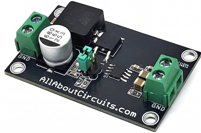

This compact buck converter module accepts input voltages from 7 V to 60 V DC and steps them down to either 5.0 or 3.3 V. The output voltage is selectable via a jumper. The assembled module is shown in Figure 1.
Figure 1. Assembled 7 to 60 V Input Buck Converter module.

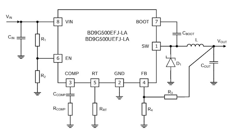

The BD9G500UEFJ-LA is an 8-pin synchronous buck controller with an integrated high-side MOSFET. On each switching cycle, the internal MOSFET connects VIN to the SW node, energizing inductor L1 and delivering current to the output. When the MOSFET turns off, the catch diode D1 provides a freewheeling path, and the inductor current continues flowing to the load. The output voltage is set by a resistor divider from the output to the FB pin. The IC regulates to maintain FB at 0.8 V. A simplified application schematic is shown in Figure 2.
Figure 2. BD9G500UEFJ-LA buck converter topology.
Figure 2. BD9G500UEFJ-LA buck converter topology. Image used courtesy of Rohm Semiconductor
Current-mode control senses the high-side MOSFET current every cycle. If an overcurrent condition occurs, the cycle is skipped. After four consecutive OCP events, the converter stops for 20 ms (typical) before attempting a restart.
During start-up, the soft-start circuit ramps the duty cycle slowly to prevent inrush current and output voltage overshoot. The RT resistor (C7, 6.8 kpF in this design) sets the switching frequency to 200 kHz. The COMP pin and its associated RC network set the loop compensation bandwidth.
Under-voltage lockout prevents operation below 6.4 V on VIN, protecting against brownout conditions. Thermal shutdown activates at a die temperature of 175°C and resets once the temperature drops by 25°C.
Over-voltage protection monitors the FB pin. When FB exceeds 1.2 V (Typ), the high-side MOSFET is disabled, and the integrated discharge MOSFET helps pull the output down. The enable pin (EN) allows the converter to be turned on and off by an external logic signal, requiring a minimum low interval of 100 µs for a valid shutdown.

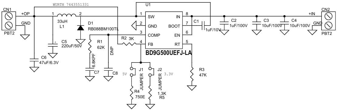

Schematic and Bill of Materials
Figure 3 shows the schematic for the buck converter design.
Figure 3. Complete schematic for the 7V to 60V Input Buck Converter.
The bill of materials is shown in Table 1.
Table 1. BOM for the 7 to 60 V Input Buck Converter.

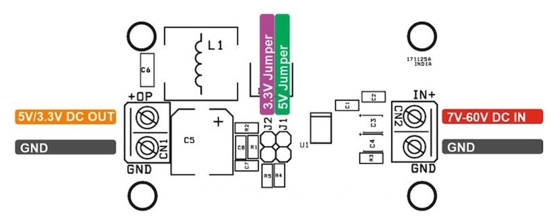

Connections
Figure 4 shows the connection diagram. Refer to the descriptions below for each connector.
Figure 4.  Connection diagram for the 7 to 60V Input Buck Converter.
CN1 — Output Connector (2-pin screw terminal, 5.08 mm pitch):
  • Pin 1 (+OP) = 5.0 or 3.3 V DC Output
  • Pin 2 (GND) = Ground
CN2 — Input Connector (2-pin screw terminal, 5.08 mm pitch):
  • Pin 1 (IN+) = 7 to 60 V DC Input
J1 — 5 V Output Selection Jumper (2-pin header, 2.54 mm pitch):
  • Install a shunt to select a 5 V output
J2 — 3.3 V Output Selection Jumper (2-pin header, 2.54 mm pitch):
  • Install shunt to select 3.3 V output
Note: Install only one jumper shunt at a time. Installing both simultaneously will result in undefined output behavior.

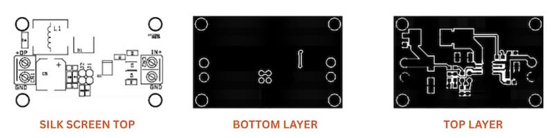

PCB Files
Figure 5 shows the silk screen, bottom, and top layers. The board dimensions are 43.34 × 32.86 mm. The Gerber files for fabrication are available for download below.
Figure 5. PCB layout:L silk screen top, bottom copper, and top
copper.
Figure 5. PCB layout: silk screen top, bottom layer, and top layer.
