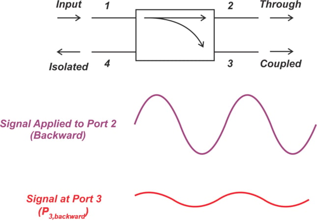

Depending on the coupling factor, a portion of the incident wave transfers to the coupled port (Port 3). Let the power of this wave component be P3,forward. Now consider a backward-traveling wave of the same power (P1) through the directional coupler: a wave of power P1 incident on Port 2.
Because Port 3 is the isolated port for this wave, the backward-traveling wave (Figure 8) should ideally have no effect on it. However, due to the non-idealities, a small portion of the backward-traveling wave also transfers to Port 3. Let the power of this component be P3,backward.
Backward-traveling wave.
Figure 8. Backward-traveling wave. Image used courtesy of Steve Arar
Let's assume that both the forward and backward waves are present. In this case, the overall wave at the coupled port (Port 3) consists of two components: the green signal from Figure 7 and the red signal from Figure 8. Clearly, the directivity of the device depends on the ratio of the power components P3,forward to P3,backward. The higher the value of P3,forward relative to P3,backward, the greater the directivity, and the closer the device is to its ideal operation.
Because directional couplers are reciprocal devices, we can find P3,backward from our first thought experiment in Figure 7. The power that transfers to the isolated port of this setup (Port 4) is equal to P3,backward. Therefore, we only need to apply a forward-traveling wave to Port 1 and measure the power that appears at the coupled and isolated ports.
The ratio of the coupled power to the power that appears at the isolated port gives us the directivity of the device. A high directivity (35 dB or greater) is usually required in the real-world applications of directional couplers. We’ll continue this discussion in a later article, when we learn how the limited directivity of directional couplers can produce errors in VNAs.
