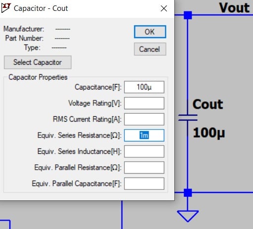

M1, M2, L, RSENSE, and COUT belong to the power stage. Note that the COUT value (Figure 2) includes 1 mΩ of ESR.
An LTspice window showing the output capacitance value for a CMC buck converter simulation. Capacitance is 100 μF and includes 1 mΩ of ESR.
Figure 2. COUT (with ESR included) for CMC buck converter simulation.

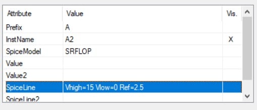

A physical implementation can resolve this complication by including charge-pump circuitry to boost the gate-drive signal. With an LTspice implementation, the solution is even simpler: I just tell the SR latch to use 15 V as a logic-high voltage (Figure 4).
LTspice window showing values for SRFLOP. It shows logic-high voltage equaling 15 V and logic-low voltage equaling 0 V.
Figure 4. Logic-high voltage definition for the SR latch (SRFLOP).
