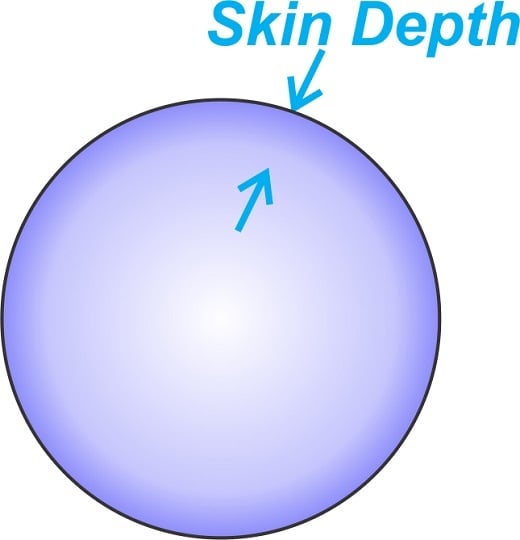

To be more accurate, the skin depth actually specifies the distance at which the current density reduces by a factor of 1/e with respect to its value at the surface of the conductor. Therefore, the current density doesn’t abruptly fall to zero after the skin depth (Figure 3).
Conceptual illustration of current distribution in a circular cross-section conductor.
Figure 3. Conceptual illustration of current distribution in a circular cross-section conductor.
However, in order to derive some simple equations for the effective cross-sectional area of the conductor, we usually assume that the whole current is uniformly distributed in the skin depth below the conductor’s surface. In a future article, we’ll discuss in greater detail the subtleties of this approximation.
