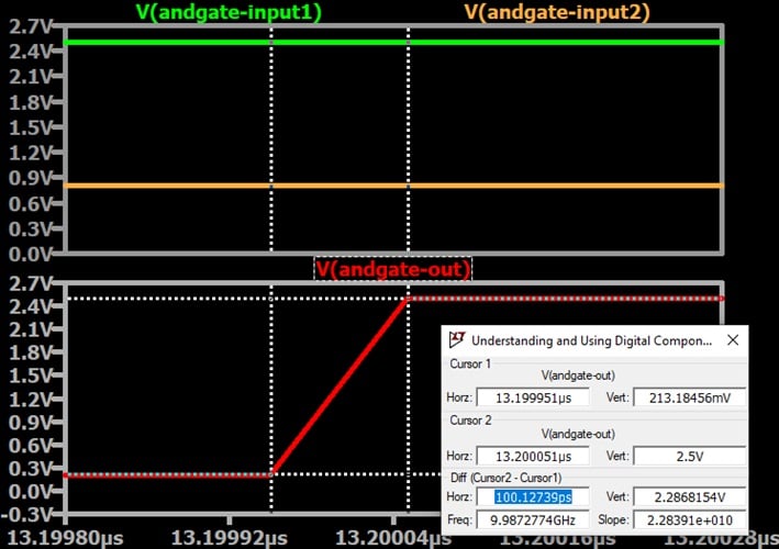

Figure 7 shows a zoomed-in output transition for the AND gate setup we used in Figure 5. Values are specified for the logic-high, logic-low, and threshold voltages, but not the rise or fall time.
AND gate low-to-high output transition with default rise time.
Figure 7. Default rise time for a low-to-high AND gate transition.
I said before that the rise time is zero by default. However, Figure 7 shows that we have a 147 ns rise time—fairly short, but definitely not zero. That’s because it’s limited by the simulation timestep. If I right-click on the simulation command and insert 100p into the Maximum Timestep field, the rise time decreases to the timestep value (Figure 8).
Low-to-high output transition with default rise time and a 100 ps simulation timestep.
Figure 8. A low-to-high output transition with default rise time and simulation timestep set to 100 ps.

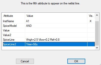

Let’s set the rise time to 50 μs. As we see in Figure 9, the process is identical to how we entered the voltage parameters.
Setting the rise time in LTspice's component attribute editor.
Figure 9. Setting the rise time in the component attribute editor.
