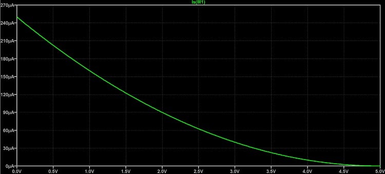

A PMOS transistor operates the same way, except that the source and body are tied to the maximum supply voltage (Figure 6).
LTspice PMOS transistor with voltage sources applied.
Figure 6. PMOS with voltage sources applied. Image used courtesy of Nicholas St. John
The threshold voltage of a PMOS transistor is negative. This means that the gate voltage must be less than the source voltage by at least the threshold voltage before the transistor begins to conduct. Figure 7 plots gate voltage and drain current for the PMOS in Figure 6.
Drain current versus gate voltage for a PMOS transistor.
Figure 7. Drain current (y-axis) vs. gate voltage (x-axis) for a PMOS transistor. Image used courtesy of Nicholas St. John
As we can see, the PMOS conducts more current when |VGS| becomes larger than |Vth|.
