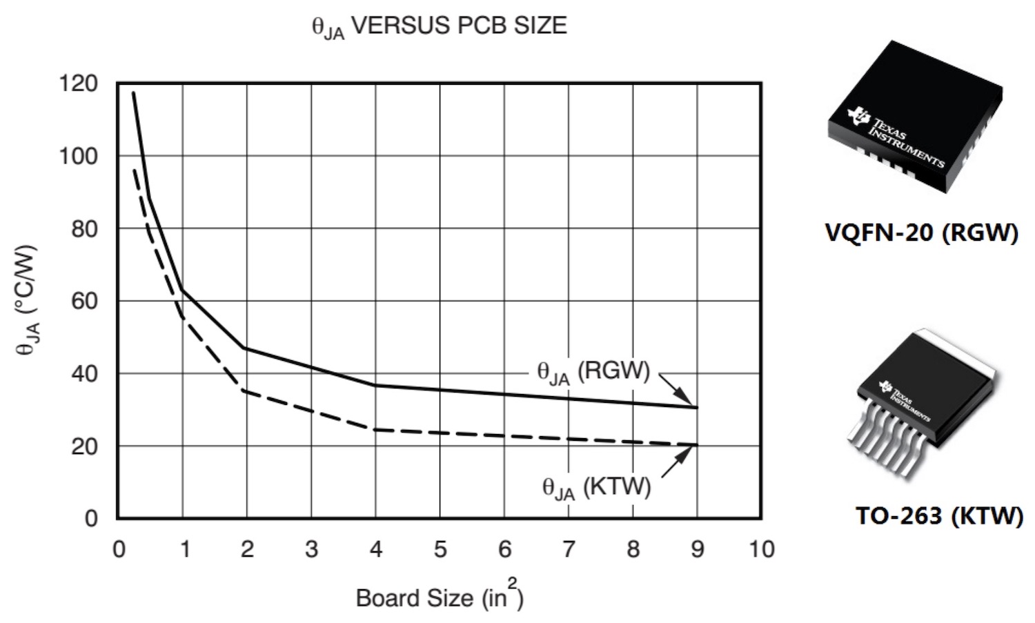

Hence, the θJA value reported in the device datasheet might not provide us with a reasonably accurate estimation of the thermal performance of our end design. The figure below shows how board size can change the value of the θJA parameter.
Image courtesy of Texas Instruments
Hence, the datasheet θJA can only be used as a first-order approximation of the thermal performance in an application-specific environment.
