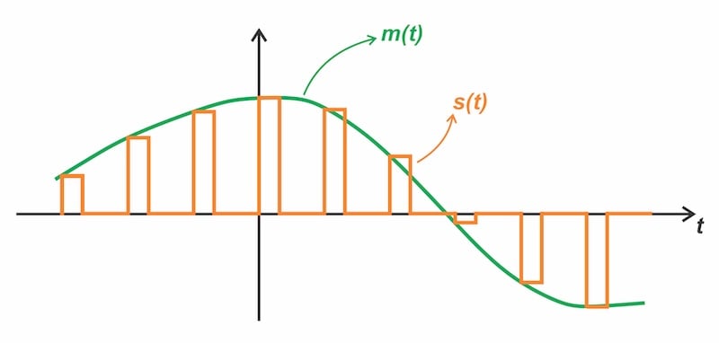

PAM is the simplest member of the analog pulse‑modulation family. It operates by sampling the message signal at regular intervals and using those sample values to set the amplitudes of a sequence of uniformly spaced pulses. Figure 1 shows the message signal together with its corresponding PAM waveform.
Figure 1. Message signal (green) and the corresponding PAM waveform
(orange).
Figure 1. Message signal (green) and the corresponding PAM waveform (orange).
PAM shares a clear analogy with continuous‑wave amplitude modulation (AM): whereas AM varies the amplitude of a sinusoidal carrier, PAM varies the amplitudes of a sequence of pulses. Before diving into the details of PAM, it’s helpful to pause and consider why this modulation scheme is important—what, exactly, is gained by encoding information in pulse amplitudes rather than in a continuous carrier? As the next section will show, PAM serves as the basis for efficient time‑division multiplexing.

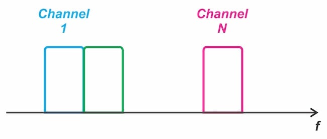

In communication systems, multiple‑access methods are needed to allow several users to share the same physical channel without interfering with one another. In frequency‑division multiple access (FDMA), each user is assigned a separate portion of the available spectrum, so multiple users can transmit simultaneously without interfering with one another. This is illustrated in Figure 2.
Figure 2. Frequency-division multiple access.

PAM can be generated either by natural sampling or by using flat‑top pulses. In flat‑top PAM, the pulse amplitude—set by the sampled value of the signal—remains constant throughout the pulse duration. This results in rectangular pulses with flat tops, as illustrated in Figure 1.

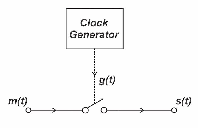

As observed, when the switching pulse is high, the output s(t) tracks the input signal, and when the pulse is low, the output is forced to zero. Therefore, natural sampling preserves the message signal’s structure, while flat‑top sampling produces a staircase‑like sequence of held sample values. Flat‑top PAM is better suited for conversion to PCM, whereas the naturally sampled form is easier to generate and finds use in other applications. As depicted in Figure 5, natural‑sampling PAM is easily implemented with an analog switch, which is a readily available component in CMOS technology.
Figure 5. Using an analog switch to generate natural‑sampling PAM.

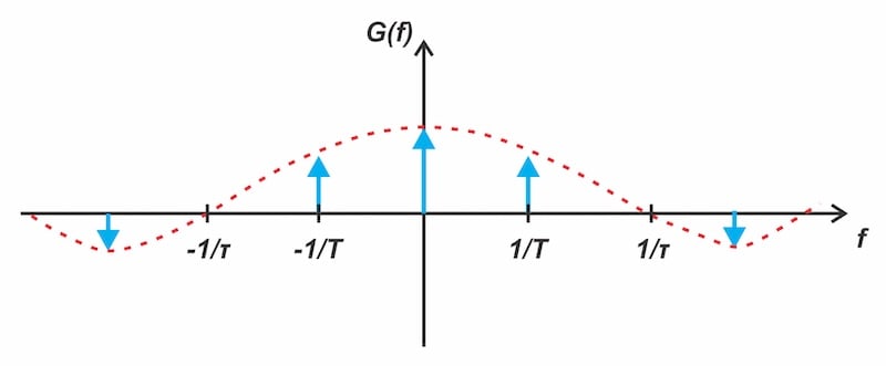

The next step is to determine the Fourier transform of the gating function g(t), which is a periodic rectangular pulse train of period T whose pulses have unit amplitude and remain high for τ. We place the time origin at the center of the high interval, making the waveform even and simplifying the analysis without loss of generality. Using the Fourier series representation, we can express g(t) in terms of its constituent frequency components:
$$g(t) = \sum_{n= - \infty} ^{+ \infty} c_n \ e^{jn (2 \pi / T) t}$$
Equation 3.
where the Fourier coefficients are given by:
$$c_n = d \ \frac{sin(n \pi d)}{n \pi d}$$
Equation 4.
The coefficients form a sinc‑shaped sequence that depends on the duty cycle d = τ/T. Once the Fourier series of a periodic signal is known, its Fourier transform follows directly: the transform consists of impulses at the harmonic frequencies n/T with weights equal to the Fourier‑series coefficients:
$$G(f) = \sum_{n=-\infty}^{\infty} c_n\,\delta\!\left(f - \frac{n}{T}\right)$$
Equation 5.
Therefore, the Fourier transform of g(t) takes the typical form illustrated in Figure 6.
Figure 6. Typical spectrum of the rectangular switching waveform.
As observed, the Fourier transform of the pulse train consists of impulses at the harmonic frequencies n/T, with amplitudes following the familiar sinc envelope of a single rectangular pulse. Combining Equations 2 and 5, the Fourier transform of the modulated signal is found as:

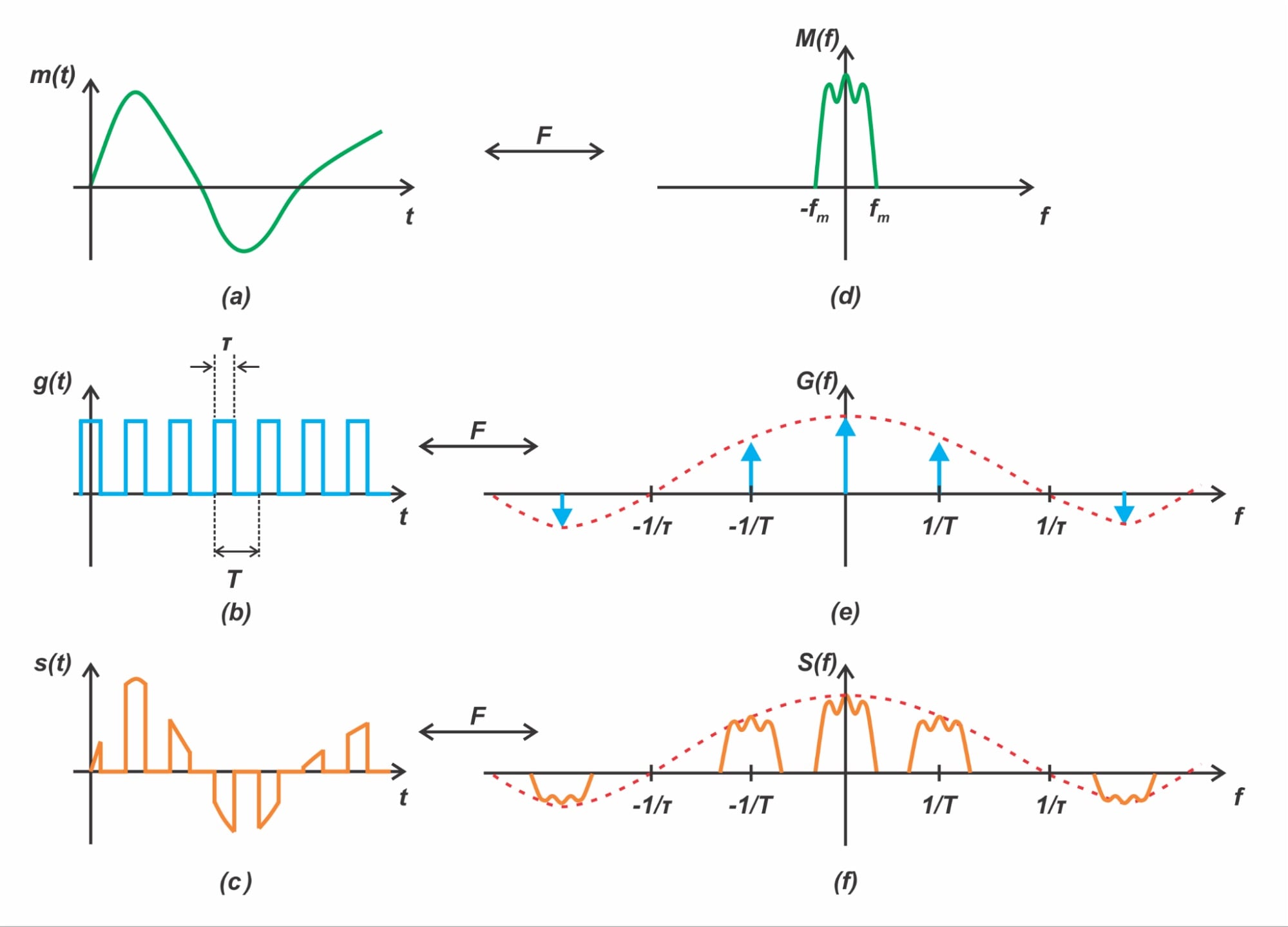

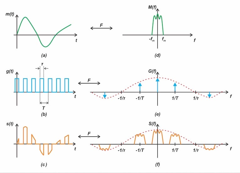

We need one more piece of knowledge to find the output spectrum: convolving an arbitrary spectrum M(f) with a shifted impulse δ(f − f1) simply shifts the spectrum to the impulse’s frequency location. Hence, the output spectrum contains shifted replicas of the message spectrum at the harmonic frequencies, each scaled by the corresponding coefficient cn. To bring the discussion together, Figure 7 uses a representative message spectrum to illustrate the typical output spectrum.
Figure 7. Illustration of natural‑sampling PAM, showing thetime‑domain waveforms m(t), g(t), and s(t) together with their correspondingspectra.
Figure 7. Illustration of natural‑sampling PAM, showing the time‑domain waveforms m(t), g(t), and s(t) together with their corresponding spectra [click to enlarge].
Specifically, parts (a) and (d) in the above figure show the message time-domain waveform and its spectrum; parts (b) and (e) depict the switching waveform and its spectrum; and parts (c) and (f) illustrate the modulated signal and its spectrum. A few observations are in order here:
  1. From Figure 7(f), we see that to prevent overlap between the spectral replicas, the pulse rate fs = 1/T must exceed twice the highest frequency present in the message signal, in accordance with the sampling theorem.
  2. Because the spectrum of the input analog waveform is replicated at the harmonics of the sampling frequency, the resulting PAM signal occupies a bandwidth far greater than that of the original analog signal.
  3. As shown in Figure 7(e), the envelope of the Fourier‑series coefficients crosses zero at 1/τ. Using the relations τ = dT and fs = 1/T, this first null occurs at a frequency of fs/d. Consequently, a smaller duty cycle produces a PAM signal with a wider bandwidth. Taking the null frequency fs/d as a bandwidth indicator, we find that the spectrum extends to approximately ±3fs when the duty cycle is d = 1/3. Moreover, if the sampling rate is chosen to be four times the message bandwidth fm, the resulting PAM signal occupies a bandwidth roughly 12 times larger than that of the original message.
