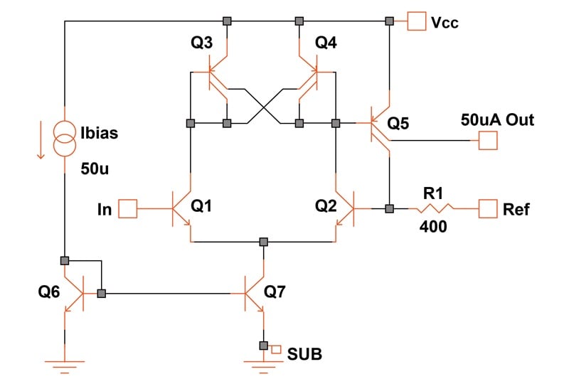

Figure 11-3 shows a comparator with hysteresis.
Bipolar comparator circuit with hysteresis.
Figure 11-3. Bipolar comparator with hysteresis.
This comparator adds two new features:
  • Q3 and Q4 form a flip-flop with precisely controlled gain, giving the circuit a snap action. This replaces the simple current mirror.
  • The diode connection of Q4 makes Q5 into a current mirror. Each collector sources one-half of the current.
The current from one of the Q5 collectors is fed into a 400 Ω resistor, causing the reference voltage at the base of Q2 to increase by 10 mV. The resistor value can, of course, be changed to increase or decrease this value. Note that the voltage at Ref must be capable of sinking Q5’s collector current.

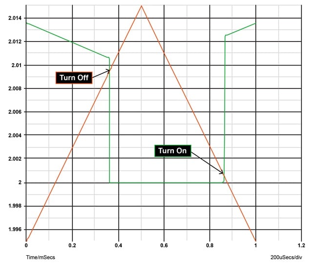

As the input voltage decreases from some value above the reference voltage, the current out of the output terminal abruptly increases from zero to about 25 μA. Because of the Early effect, the exact level depends on the output voltage. As Figure 11-4 illustrates, you now have to increase the input voltage to 10 mV above the reference level to turn the output current off.

Simulating a Comparator With Hysteresis
A comparator with hysteresis requires some thought before simulating or testing, since the two different thresholds have to be approached in the proper sequence. In a simulation, this can be done with a transient analysis (as demonstrated above in Figure 11-4). We let the input voltage increase until it exceeds the upper threshold, then decrease it until it reaches a level below the lower threshold.
Similarly, in testing, the input is ramped up until switching occurs. It’s then ramped down until the output changes states again.

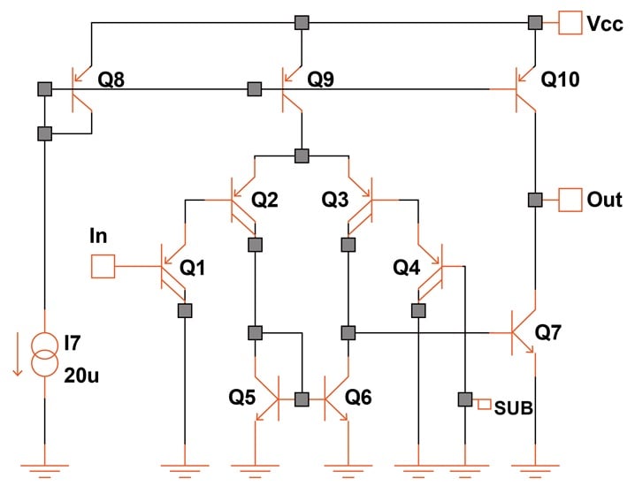

In the examples so far, NPN or N-channel transistors have been used for the input differential pair. Unless you have a split power supply, this is a disadvantage when the input signal and reference are near ground level. By converting the input to PNP or P-channel and with a couple of design refinements, a comparator can be made to work at ground level, even if there is only a single supply. This is illustrated in Figure 11-6.
A Darlington input allows the inputs to be at ground level.
Figure 11-6. A Darlington input allows the inputs to be at ground level.
This circuit uses a Darlington input stage—not to decrease the input current, but to allow the comparator to operate even if the input drops slightly below ground. (Strictly speaking, the input stage is not a pure Darlington connection, since the collectors of Q1 and Q4 go to ground).
With as much as 400 mV below ground at the input, Q1 is still in its active region. At that point, assuming it’s at room temperature, the base of Q2 is about 200 mV above ground. This is sufficient to keep Q5 from being cut off.
This circuit has a definite upper temperature limit of about 100 °C. It is also rather slow because there is no discharge path at the bases of Q2 and Q3. Since the primary object is not a low input current, however, there is no reason why we could not place two additional small current sources (like Q9) at these points.
