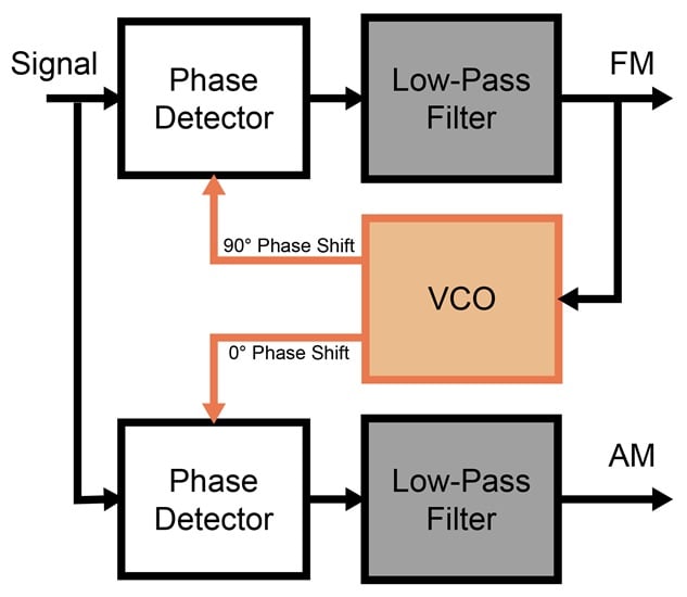

Designing a PLL for AM Modulation
As illustrated in Figure 14-8, there's even a simple PLL design if the modulation is AM rather than FM.
Phase-locked loop with AM output.
Figure 14-8. Phase-locked loop with AM output.
The VCO now has two outputs. Both have the same frequency, but the second output is shifted by 90 degrees. A second phase detector and lowpass filter are also added.
In the middle of the lock range, the phase shift between the signal and the VCO is automatically 90 degrees. The control voltage for the VCO is therefore zero. This means that the signal frequency is chopped at the amplitude peaks.
A second phase detector operating at 0 degrees phase shift will chop the same signal at the zero crossing. The result is a voltage proportional to amplitude. The AM output in Figure 14-8 is the demodulated AM signal and also indicates that the loop is locked.
