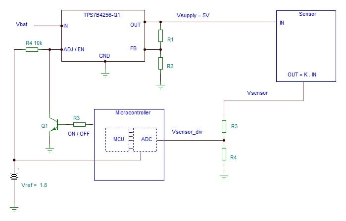

If Vref and Vsupply are different voltages, then you must use resistor dividers. In Figure 2, for example, Vsupply = 5 V and Vref = 1.8 V.
Schematic of a ratiometric data-acquisition system where Vsupply ≠ Vref.
Figure 2. Schematic of a ratiometric data-acquisition system where Vsupply ≠ Vref.
A resistor divider composed of R1 and R2 in the feedback path of the Tracking LDO is used to scale Vref up to Vsupply as follows:
$$V_{supply}~=~V_{ref}\frac{R_1~+~R_2}{R_2}~=~V_{ref}(1~+~\frac{R_1}{R_2})$$
Equation 4.
Another divider must scale Vsensor down to fit within the ADC’s Vref range:
$$V_{sensor\text{_}div}~=~V_{sensor}\frac{R_4}{R_3~+~R_4}$$
Equation 5.

In Figure 2, the errors introduced into the system by the two resistor dividers aren’t cancelled. This limits the accuracy of the measurement.
One source of error is the output offset voltage of the LDO. The Vos of the tracker LDO is multiplied by (R1 + R2)/R2 and appears on the output. For example, in a system where Vsupply = 5 V and Vref = 1.8 V, the output Vos maximum is:
$$V_{os,max}~=~6~\text{mV}~\times~\frac{5~\text{V}}{1.8~\text{V}}~=~16.7~\text{mV}$$
Equation 6.
This error is divided back down again by R3 and R4 so that the Vos at the ADC is 6 mV. However, the Vref is only 1.8 V. The error from Vos at the ADC is therefore 6 mV/1.8 V = 0.33%, which is larger than when Vref was equal to 5 V.

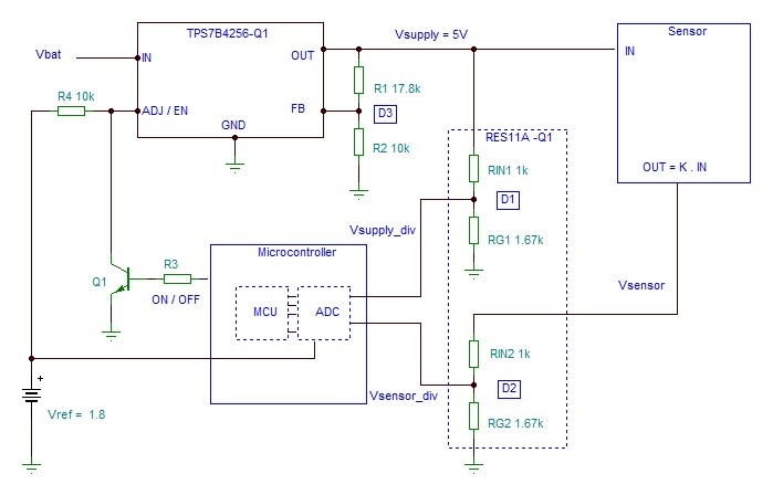

To address this, Figure 3 shows a proposed ratiometric data-acquisition system where Vsupply ≠ Vref. In this example, Vsupply = 5 V and Vref = 1.8 V. However, this approach will also work with other common ADC reference voltages.
Schematic of proposed data-acquisition system where Vsupply≠ Vref.
Figure 3. Schematic of proposed data-acquisition system where Vsupply ≠ Vref.
Comparing Figure 3 to Figure 2, there is now a resistor divider (D1) that scales Vsupply down so that it can also be captured by the ADC. Resistive dividers D1 and D2 are a matched pair integrated into the same package. As we’ll see later, divider D3 can be made on the OUT-to-FB of the tracker LDO using standard 1% tolerance resistors.
Using three dividers allows us to choose D3 so that it scales the 1.8 V reference voltage exactly to the 5 V supply voltage. If you were to use one of the matched pair of dividers instead, the ratios available wouldn’t allow for exact scaling of 1.8 V to 5 V. This is important because the sensor has a requirement for the accuracy of its Vsupply, and you want Vsupply to sit right at the nominal supply voltage of 5 V.

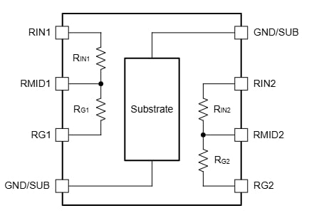

Figure 4 shows an example of a matched resistor divider network. The TI RES11A consists of two independent resistor dividers. The RES11A is available with different resistor divider ratios and versions qualified for automotive applications (the RES11A-Q1).
The RES11A or RES11A-Q1.
Figure 4. The RES11A or RES11A-Q1.
For all dividers, RINx = 1 kΩ. While the absolute tolerance of an individual resistor in the RES11A is quite loose (12% maximum), the fact that the four resistors are integrated into a monolithic package and are interdigitated with each other gives them excellent matching characteristics of ± 0.05% maximum.
The matching of the first divider to the second divider within the RES11A is also excellent, at ± 0.1% maximum. Furthermore, other errors, such as temperature drift, are also well matched. This results in a very low divider temperature drift of ΔtDx/ΔTa = ±2 ppm/°C drift mismatch maximum.
The resistor dividers, composed of RINx and RGx, can be connected in either direction to provide two different scaling voltages: RIN/(RIN + RG) or RG/(RIN + RG). Table 2 shows versions of the RES11A devices with different divider ratios and how each can be used to scale the 5 V Vsupply and Vsensor voltages to the target Vref voltage.

Let’s analyze the effectiveness of the measurement scheme in Figure 3. We’ll start by evaluating the resistor divider ratios (D1, D2, and D3). Dividers D1 and D2 are attenuators that scale down the voltage:
$$D_1~=~\frac{R_{IN1}}{R_{G1}~+~R_{IN1}}$$
Equation 7.
$$D_2~=~\frac{R_{IN2}}{R_{G2}~+~R_{IN2}}$$
Equation 8.
D3 is a multiplier that scales up a voltage:
$$D_3~=~\frac{R_1~+~R_2}{R_2}~=~1~+~\frac{R_1}{R_2}$$
Equation 9.
The output from the tracker LDO, including the Vos, is expressed by:
$$V_{supply}~=~D_3(V_{ref}~+~V_{os})$$
Equation 10.
Vsupply is measured by the ADC through resistor divider D1 to give Vsupply_div:
$$V_{supply \text{_} div}~=~D_1D_3(V_{ref}~+~V_{os})$$
Equation 11.
The sensor has a gain of K (0 ≤ K ≤ 1) and its output is proportional to its supply voltage. The sensor output is measured by the ADC through divider D2 as shown in Equation 12:
$$V_{sensor \text{_} div}~=~K D_2 V_{supply}~=~K D_2 D_3(V_{ref}~+~V_{os})$$
Equation 12.
The ADC has N bits and uses Vref. It performs a single-ended, unipolar measurement with an output expressed as:
$$ADC~output~=~\frac{V_{input}}{V_{ref}}(2^N~-~1)$$
Equation 13.
where Vinput is the voltage input to the ADC.
Equations 14 and 15 calculate the digitized Vsupply_div and Vsensor_div voltages as:
$$V_{supply\text{_}div\text{_}digitized}~=~D_1D_3\frac{V_{ref}~+~V_{os}}{V_{ref}}(2^N~-~1)$$
Equation 14.
$$V_{sensor\text{_}div\text{_}digitized}~=~KD_2D_3\frac{V_{ref}~+~V_{os}}{V_{ref}}(2^N~-~1)$$
Equation 15.
The microcontroller takes the digitized ADC readings of Vsupply_div_digitized and Vsensor_div_digitized and computes the ratio:
$$Computed~ratio~=~\frac{V_{sensor\text{_}div\text{_}digitized}}{V_{supply\text{_}div\text{_}digitized}}~=~K\frac{D_2}{D_1}$$
Equation 16.
The computed ratio value is independent of Vref, Vsupply, Vos, and D3. That’s why it’s possible, as we mentioned earlier, to make divider D3 using standard 1% tolerance resistors.
If the two resistor dividers in the RES11A (D1, D2) are perfectly matched, then D1 = D2 and the resulting computed ratio = K. The acquisition system is measuring only K, which is the output of the sensor from 0 to 100% of full scale.
In practice, dividers D1 and D2 are not error-free. Let’s analyze that in the next section.

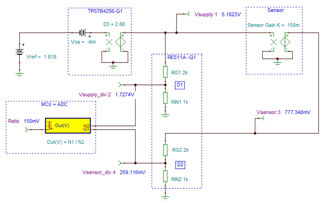

Using the TINA-TI™ software, we’ve developed a behavioral model of the proposed ratiometric data-acquisition system. Figure 5 shows this system set up to run a DC simulation.
TINA-TI software DC analysis of a ratiometric data-acquisition system where Vsupply ≠ Vref.
Figure 5. TINA-TI software DC analysis of a ratiometric data-acquisition system where Vsupply ≠ Vref. [click to enlarge]
The TPS7B4256-Q1 tracker LDO is modeled as a gain equal to D3. The RES11A20, with RINx = 1 kΩ and RGx = 2 kΩ, is used to scale 5 V to 1.67 V. The output of the sensor is set to K = 0.15.
To see how the system reacts in the presence of errors, D3 is increased by 3% to 2.86, Vos = –6 mV, and Vref is increased by 1% to 1.818 V. In Figure 5, the computed ratio remains at the ideal value of 0.15, which is K.
