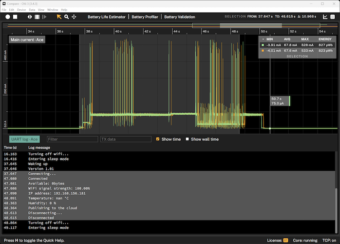

These enable you to synchronize results visualizations and compare multiple power measurement recordings. You can easily add new recordings to existing projects and carry out extended measurements and benchmarking. All of this can be done in real-time (Figure 1), so the impact of firmware and software changes on system power consumption can be evaluated instantly.
Comparing power measurements in real-time enables the effect of even small software changes to become immediately apparent when estimating the operating life of IoT devices using Otii Arc/Ace Pro.
Figure 1. Comparing power measurements in real-time enables the effect of even small software changes to become immediately apparent when estimating the operating life of IoT devices using Otii Arc/Ace Pro. Click image to enlarge
When power consumption increases, it can indicate that a bug has been introduced that may not have been revealed in functional tests. However, with the latest test equipment, you can synchronize a UART log output with power metrics to produce detailed insights into your project’s power profile. This functionality makes a significant contribution to software quality assurance.
