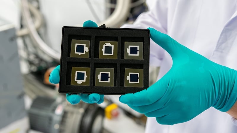

The National University of Singapore has achieved a milestone in solar cell technology by developing triple-junction tandem solar cells with a world-record efficiency of 27.1%. This feat was accomplished by integrating a novel pseudohalide, cyanate, into perovskite solar cells—a move that not only stabilized the perovskite structure but also significantly reduced energy loss.
The NUS triple-junction solar cell
The NUS triple-junction solar cell. Image used courtesy of NUS
The success of these cyanate-integrated perovskite solar cells in achieving higher voltages and maintaining stability under continuous operation marks a significant step forward in the quest for more efficient and sustainable energy solutions.
