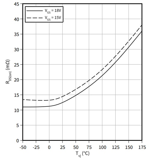

Infineon has also revealed new CoolSiC MOSFETs that push toward higher voltage handling capabilities. The new 2,000 V CoolSiC series provides higher voltage headrooms, allowing designers to leverage the FETs to increase the margin of safety compared to previous generations that break down at 1,700 V.
The CoolSiC 2,000 V series' low on-resistance
The CoolSiC 2,000 V series' low on-resistance allows designers to handle large currents and voltages.
The 2,000 V series of CoolSiC MOSFETs (datasheet linked) can support up to 123 A of drain current, with a corresponding 12 mΩ on-resistance. Infineon specifically mentions 1,500 V DC link systems as a potential application. However, because of its breakdown voltages and currents, the 2,000 V series can be used in many applications, including fast EV charging and solar energy.

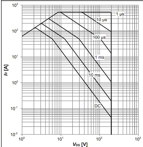

Infineon also recently announced the OptiMOS 6 family of MOSFETs, which improves power density and reliability in smaller devices. As more applications turn to switching power supplies, the improvements offered by the OptiMOS 6 series (datasheet linked) allow designers to continue shrinking designs.
The power density of the OptiMOS 6 series
The power density of the OptiMOS 6 series creates a wide safe operating area.
Compared to the previous generation, OptiMOS 6 offers a 42% lower on-resistance and 89% lower reverse recovery charge, allowing designers to improve efficiency and EMI performance. In addition, the OptiMOS 6 can support voltages up to 200 V, which is critical for many applications. The OptiMOS 6 series targets a wide swath of use cases from e-scooters to compact server or telecom systems. The series is also useful for static switching applications, including battery management systems.
