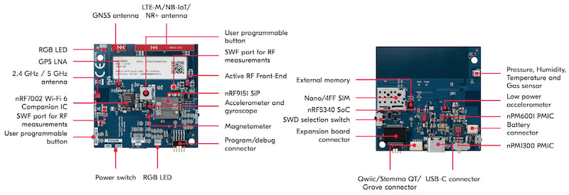

The internal layout of the Thingy:91 X
The internal layout of the Thingy:91 X.
The nRF5340 SoC, on the other hand, serves as the board controller. It features a dual-core architecture with a 128-MHz, high-performance Cortex-M33 application core and a 64-MHz, low-power network core. The SoC supports 1 MB of Flash memory and 512 KB of RAM and TrustZone and CryptoCell 312 security. The SoC offers the standard suite of peripheral interfaces, including SPI, UART, I2C, PWM, and ADC.
Nordic says the SiP and SoC together create a powerful, energy-efficient platform. The nRF9151 ensures robust cellular and GNSS capabilities, while the nRF5340 adds flexible connectivity and advanced computational resources, making the Thingy:91 X useful for IoT prototyping and deployment.
Power efficiency is also important, with the nPM1300 PMIC providing accurate fuel gauging and charging for the system’s 1350-mAh Li-Po battery. Environmental and motion data are captured using sensors for temperature, humidity, air quality, air pressure, acceleration, and a six-axis IMU.
