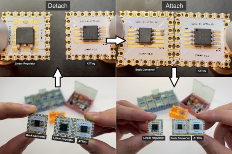

Stamp is modular and reusable
Because Stamp is modular and reusable, users can break large circuits into small, swappable blocks. In this example, the user is easily swapping out a linear regulator Stamp for a buck converter Stamp—all without needing to redesign a PCB.
A more complex circuit based on Stamp can take a variety of different shapes, ranging from flat daisy-chained boards to right-angle connections and even complete six-sided cubes. The company's engineering team has demonstrated these possibilities by developing a three-dimensional LED matrix cube made up of six Stamps and an ATtiny-based robot control board made up of four Stamps.
Stamps can also stack on top of one another and other kinds of PCBs. This means that they can serve as a basis for shields and hats that could then be used with development boards such as the Arduino Nano or the Raspberry Pi Pico.
