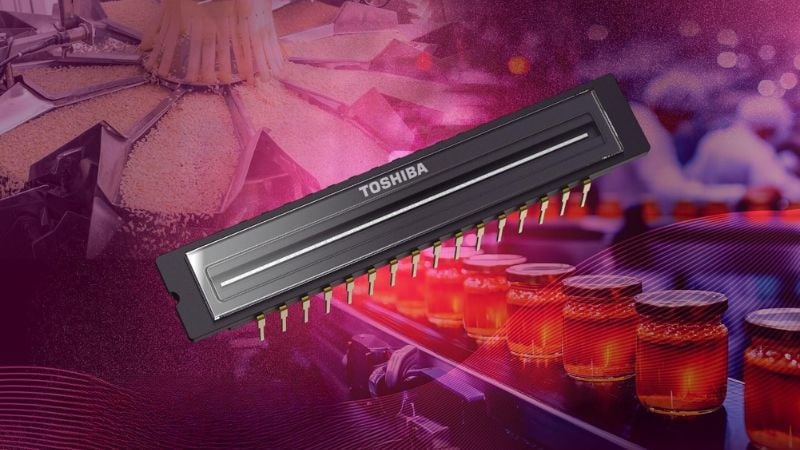

Toshiba recently announced the new TCD2400DG high-speed linear RGB CCD image sensor. The CCD comes in a 4,096-pixel-wide x three (RGB) arrays, yielding a 28.672-mm image capture area. Toshiba designed the sensor to meet the needs of high-speed scan cameras used in quality control, food sorting, and high-precision inspection.
TCD2400DG
The new Toshiba TCD2400DG CCD sensor.
The TCD2400DG (datasheet linked) tops out the speed capability in its product family at a 22.7-kHz line rate. This is accomplished at a maximum data rate of 100 MHz (50-MHz master clock frequency × two channels). That is more than twice the line rate of the TCD2564DG, Toshiba’s prior 4,096-pixel performance leader. The new CCD achieves its performance through highly sensitive PN-junction photodiodes with a 7-µm by 7-µm sensing area, enabling fine spatial resolution.

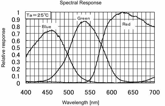

Sensor spectral response curve
Sensor spectral response curve. (Datasheet, page 12)
It is housed in a 32-pin CERDIP package measuring 53.6 mm × 9.65 mm. In terms of spectral response, the sensor offers red sensitivity of 14.7 V/lux-second, green sensitivity of 16.6 V/lux-second, and blue sensitivity of 6.9 V/lux-second.
