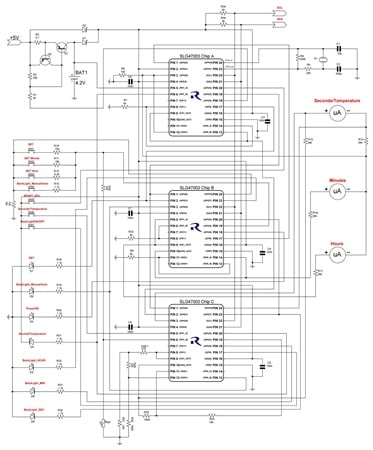

Figure 2 shows the full Analog Clock schematic. Click on the image to open a high-resolution version.
Complete schematic for the Analog Clock project.
Figure 2. [click to enlarge] Complete schematic for the Analog Clock project.

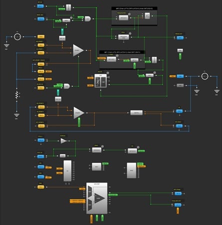

Figure 3 shows the design of Chip A. As with the schematic in Figure 2, you can click on the image to view it at full size in a new tab.
Design of Chip A.
Figure 3. [click to enlarge] Design of Chip A for the Analog Clock
Crystal Oscillator and Divider-by-32768/Second Pulse Generator
The stable pulse generator responsible for generating one-second timing pulses is built using the 2-bit LUT0 (with inverter settings), P DLY, 8-bit CNT3/DLY3 and 8-bit CNT4/DLY4. CNT3 is configured as a divide-by-128 frequency divider, while CNT4 is configured as a divide-by-256 frequency divider. The cascaded connection of the 8-bit CNT3/DLY3 and the 8-bit CNT4/DLY4 results in an overall division ratio of 32,768, thereby generating output pulses with a 1 s period.

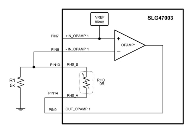

A non‑inverting amplifier is implemented using OPAMP1, whose gain is adjusted by means of the digital rheostat RH0 (Figure 4).
Circuit configuration of OPAMP1 as a step voltage generator.
Figure 4. Circuit configuration of OPAMP1 as a step voltage generator.
A stable voltage of 96 mV provided by VREF OA1 is applied to the +IN input of OPAMP1. Thus, OPAMP1 amplifies the input voltage with a gain equal to K. The gain factor is calculated according to the following equation:
$$K~=~1~+~RH0/R1$$
The digital rheostat RH0 has a maximum resistance of approximately 100 kΩ. The minimum resistance is close to 0 Ω. When the resistance of the digital rheostat is varied from 0 to 100 kΩ, the gain of OPAMP1 (assuming R1 = 5 kΩ) changes from 1 to approximately 21. Accordingly, the output voltage of OPAMP1 varies from 96 mV to approximately 2000 mV.
By dividing the entire resistance adjustment range of the digital rheostat into 60 equal steps and increasing the rheostat resistance by 1/60 of its full-scale value each second, a stepwise increasing voltage can be obtained at the output of OPAMP1.

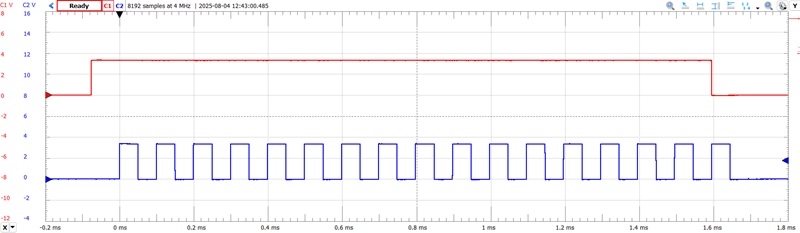

The 8‑bit CNT1/DLY1 generates a pulse with a duration of approximately 1.6 ms on the rising edge of each one‑second pulse. The DFF12 synchronizes this pulse with the OSC0 clock signals. By means of the 3‑bit LUT1, the resulting pulse is filled with 17 clock pulses from OSC0 (see the oscilloscope waveform in Figure 5).
The pulse burst generation circuit waveform.
Figure 5. The pulse burst generation circuit waveform. C1 (red) – 8-bit CNT1/DLY1 output; C2 (blue) – 3-bit LUT1 output.

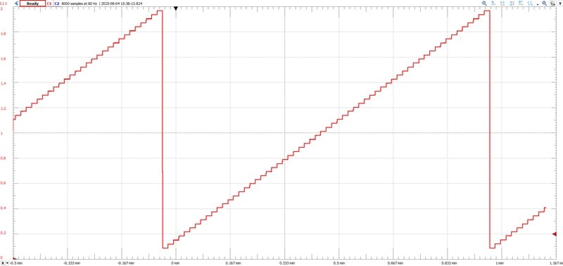

At the output of OPAMP1 we receive a cyclic step signal (Figure 6), which can be displayed using an analog microammeter.
The second's step signal generation circuit waveform.
Figure 6. The second's step signal generation circuit waveform.

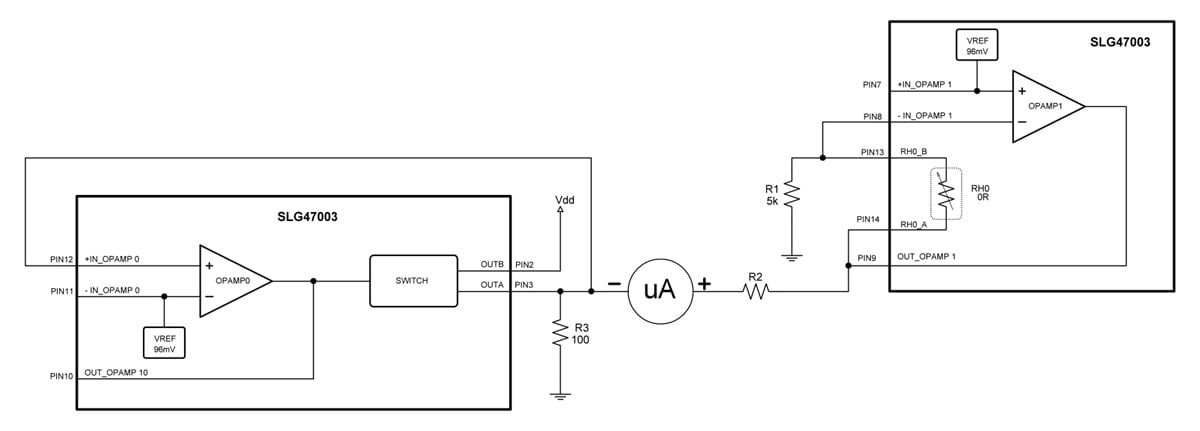

The step voltage changes from 96 mV, so part of the microammeter scale will not be involved (the arrow will not return to the 0-scale mark). To get rid of this effect, the design uses the circuit on the left side of Figure 7.
Circuit configuration for connecting the microammeter.
Figure 7. [click to enlarge] Circuit configuration for connecting the microammeter.
This circuit is a voltage stabilizer with an output of 96 mV. Thus, if we turn on the microammeter between the output of this stabilizer and the output of OPAMP1, this will compensate for the offset of the step voltage and the microammeter arrow will return to the zero-scale value.
