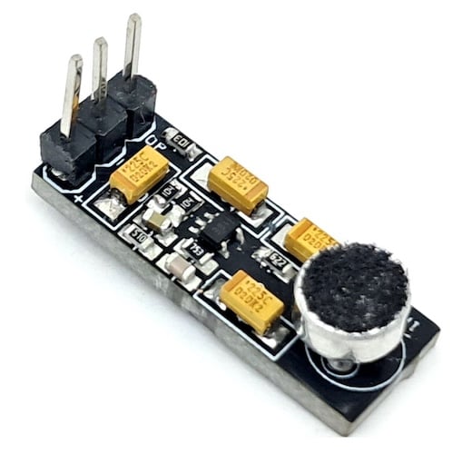

Electret microphones are common in portable electronics because of their small size, low cost, and good signal-to-noise ratio. This module pairs a PUI Audio condenser microphone with a Texas Instruments TLV6741 operational amplifier to build a single-supply preamplifier for that microphone. The board runs from a single 5 V rail. It connects to a host system through a 3-pin header that carries power, ground, and the amplified audio output, shown in Figure 1.
Figure 1. The assembled Microphone Amplifier, 5V Supply module, with the electret microphone capsule and 3-pin header visible.
Figure 1. The assembled Microphone Amplifier with the electret microphone capsule and 3-pin header visible.
The TLV6741 is a 10 MHz op amp with low broadband noise. Its small SC70-5 package and low operating voltage make it well suited to this kind of preamplifier circuit.
The circuit uses the op amp in a transimpedance amplifier configuration, converting the microphone's current output into an output voltage. A resistive divider biases the non-inverting input at mid-supply, holding the common-mode voltage constant. This eliminates input-stage crossover distortion that would otherwise appear at the extremes of the signal swing.
Specs and Features
  • Power input: 5 V DC
  • Frequency response: 20 Hz to 20 kHz
  • Output voltage: 1.2 V
  • Key IC: Texas Instruments TLV6741 op amp (SC70-5 package, 10 MHz, low broadband noise)
  • Microphone: PUI Audio condenser microphone (MK1)
  • Single 3-pin header for power, ground, and audio output
  • PCB dimensions: 22.54 mm x 8.26 mm

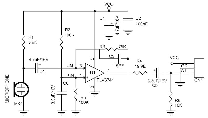

The electret microphone MK1 generates a small AC current in response to sound pressure. Capacitor C4 couples that signal into the inverting input of the TLV6741. Resistor R1 and capacitor C4 set the input high-pass corner. Feedback resistor R3 and capacitor C3 set the gain and the upper-frequency roll-off of the amplifier, together defining the circuit's 20 Hz to 20 kHz passband.
Resistors R2 and R5, along with capacitors C6 and C1, bias both op amp inputs at mid-supply. This bias network keeps the amplifier centered between rail and ground. As a result, the output swings symmetrically around 1.2 V without clipping or crossover artifacts. On the output side, resistor R4 and capacitor C5 form an output filter and DC-blocking network before the signal reaches header CN1. Resistor R6 provides a bias path for the following stage.
Schematic and Bill of Materials
Figure 2. Schematic of the Microphone Amplifier, 5V Supply circuit,built around the TLV6741 transimpedance amplifier.
Figure 2. Schematic of the Microphone Amplifier.
The bill of materials is shown in Table 1.
Table 1. BOM for the Microphone Amplifier
REF DESCRIPTION QTY MFG SUPPLIER PART NO.
CN1 3 pin male header, pitch 2.54 mm 1 Wurth Digikey 732-5316-ND
C1, C4 4.7 µF / 16 V tantalum, 1206 2 Kemet Digikey
C2 100 nF / 50 V ceramic, 0805 1 Yageo/Murata Digikey
C3 15 pF / 50 V ceramic, 0805 1 Yageo/Murata Digikey
C5, C6 3.3 µF / 16 V tantalum, 1206 2 Kemet Digikey
MK1 Condenser microphone 1 PUI Audio Digikey 668-1197-ND
R1 5.9 kΩ 1%, 0805 1 Yageo/Murata Digikey
R2, R5 100 kΩ 5%, 0805 2 Yageo/Murata Digikey
R3 75 kΩ 1%, 0805 1 Yageo/Murata Digikey
R4 49.9 Ω 1%, 0805 1 Yageo/Murata Digikey
R6 10 kΩ 5%, 0805 1 Yageo/Murata Digikey
U1 TLV6741, SC70-5 1 TI Digikey 296-48176-1-ND

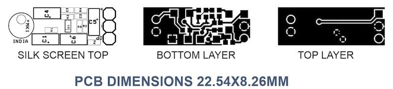

PCB Files
Figure 3. PCB layout for the Microphone Amplifier, 5V Supply, showingthe top silkscreen, bottom layer, and top layer. Board dimensions are 22.54 mm x8.26 mm.
Figure 3. PCB layout for the Microphone Amplifier showing the top silkscreen, bottom layer, and top layer.
You can download the layout files for this project here:
Microphone Amplifier Gerber Files
