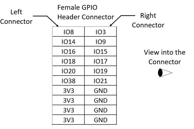

The Elecrow e-paper HMI display used in this project integrates the electrophoretic layer with an onboard ESP32S3 microcontroller and a communication interface driver IC. A serial peripheral interface (SPI) enables the e-paper to receive images from the microcontroller.
The e-paper display driver operates at 3.3 V logic levels, which aligns with the ESP32S3 microcontroller general-purpose input/output (GPIO) pins. Additional GPIO pins are available for external interface and control of the e-paper display through the dual-in-line female header connector (Figure 3).
The Elecrow e-paper display's female header connector.
Figure 3. The Elecrow e-paper display's female header connector.

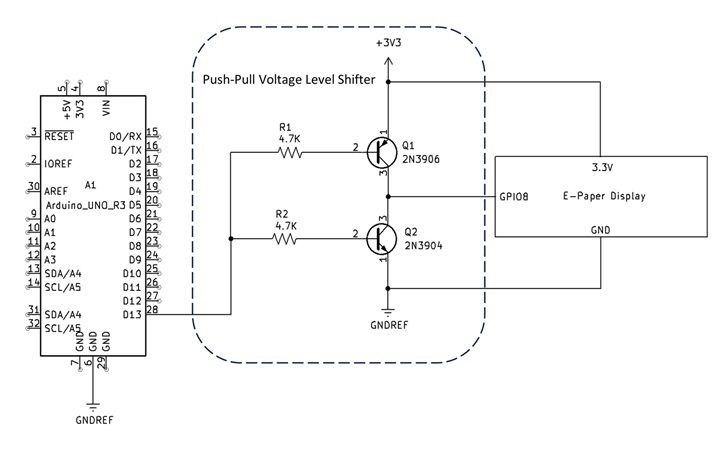

The Push-Pull Voltage Level Shifter: Schematic and Basic Operation
The circuit schematic for our project is shown in Figure 4.
The push-pull level shifter circuit interfaced with the e-paper display and the Arduino Uno.
Figure 4. [click to enlarge] The push-pull level shifter circuit interfaced with the e-paper display and the Arduino Uno.
The push-pull level shifter consists of a complementary transistor pair:
  • A PNP transistor (Q1 = 2N3906).
  • An NPN transistor (Q2 = 2N3904).
The transistors are arranged so that one device sources current to the output while the other sinks it. The bases of both transistors are driven from the Arduino Uno's digital output through individual 4.7 kΩ base resistors (R1 and R2). The output of the circuit, which connects to the e-paper display input pin, is taken from the common collector node of both transistors. This node toggles between approximately 3.3 V (logic HIGH) and 0 V (logic LOW), depending on the input state of the Arduino Uno.
When the Arduino Uno output is HIGH (5 V), Q2 becomes forward-biased. This means that its base-emitter junction voltage, VBE(Q2), exceeds 0.7 V. Transistor Q2 saturates, pulling the output close to ground (LOW). At the same time, the high input voltage reverse-biases Q1, turning it OFF.
When the Arduino Uno output goes LOW (≈ 0 V), transistor Q1 becomes forward-biased since its base-emitter voltage (VBE (Q1) ) exceeds 0.7 V. This allows current to flow from the 3.3 V supply through Q1 to the output, producing a logic HIGH around 3.1 V. In this way, the circuit inverts the logic state of the input while safely converting 5 V logic to 3.3 V logic.

Project Build: Wiring the Arduino Uno to the E-Paper Display
Now that we understand how the level shifter operates, we're ready for the project build. To construct the interface, consult the schematic in Figure 4 and follow these steps:
  1. Insert the 2N3906 and 2N3904 transistors (Q1 and Q2) into a solderless breadboard.
  2. Connect the emitter of Q1 to the e-paper display's 3.3 V supply rail, and the emitter of Q2 to ground.
  3. Join the collectors of the two transistors together. This node will serve as the output that drives the e-paper display's GPIO8 input pin.
  4. Attach one 4.7 kΩ resistor (R1) between the Arduino Uno's digital output pin D13 and the base of Q1, and another 4.7 kΩ resistor (R2) between the same Arduino Uno pin and the base of Q2.
  5. Connect the level shifter circuit's 3.3 V and GND rails to the e-paper display's regulated 3.3 V source and the Arduino Uno ground, ensuring a common reference between both devices.

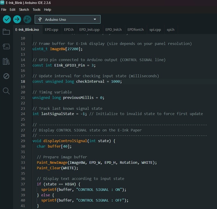

Once we've confirmed that the level shifter works, all that's left for us to do is test the e-paper display. To complete this step, you'll need to install some test code, which can be found by following this link.
After you've downloaded the code, upload it to the Elecrow e-paper display using the Arduino Uno IDE.
The test code will read the translated voltage from the level shifter circuit and respond by displaying either CONTROL SIGNAL: ON or CONTROL SIGNAL: OFF, depending on whether the Arduino Uno's digital output pin is HIGH or LOW. To see what this looks like, refer either to Figure 9 or to the video included at the end of this article.
Figure 11 shows a partial listing of the e-paper display test code.
Partial listing of the e-paper HMI display test code.
Figure 11. [click to enlarge] Partial listing of the e-paper HMI display test code.
The test code is well-commented, allowing modification to the font sizes, display messages, and image refresh switching delays.
