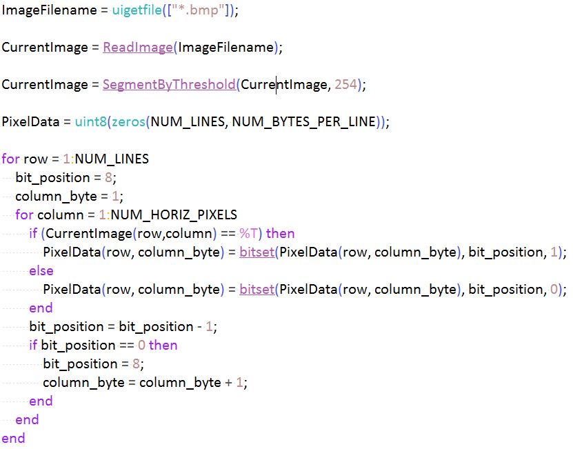

The Scilab script begins with an image processing section:
The input image must be a grayscale, 128-by-128 pixel .bmp file. The SegmentByThreshold() function converts the image from grayscale to black and white, since with our LCD the pixels are either on or off—no gray allowed. A series of bitset() operations converts this image data into pixel data that can be sent to the EFM8 and transferred directly to the LCD. Note that sophisticated computational applications like Scilab are not exactly optimized for the sort of awkward bitwise operations we are using here. In other words, the double for-loop block in the above code takes a long time to execute (e.g., about 23 seconds with a 2.5 GHz processor running Windows 8.1). Thus, if you want to adapt this code for displaying an animation sequence, you will need to convert all the images to LCD pixel format before you start sending data to the EFM8.

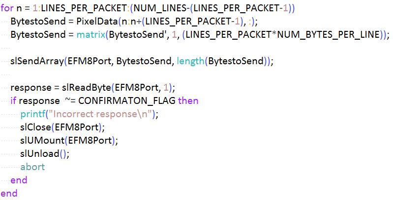

The other main section in the Scilab script is the for loop that sends the pixel data to the EFM8 via the VCP connection:
Four rows of pixel data are converted into a one-dimensional array and transmitted as a single 64-byte packet using the slSendArray() function. The script then reads the single confirmation byte from the EFM8 before sending the next four rows of pixel data. Important Note: The calls to slReadByte() in this script have “1” for the second parameter, i.e., response = slReadByte(EFM8Port, 1). This “1” indicates that the function will block, which is to say that Scilab will do nothing until at least one byte arrives. The advantage here is that the script runs as quickly as possible, because execution will continue as soon as the EFM8 sends the confirmation byte. The problem, though, is that if something goes wrong and the byte never comes, Scilab will be in a coma until you close the program and reopen it. Consequently, a better way to do this during the debugging phase is to use the sleep() function to give the EFM8 time to respond then read the byte without blocking, i.e., slReadByte(EFM8Port, 0).
The Scilab script also calls tic() and toc() to measure and display the length of time required to transfer and display one image. With the same 2.5 GHz Windows machine mentioned above, the process takes only about 50 ms, which means that this system should be able to comfortably maintain an animation frame rate of 10 images per second.
