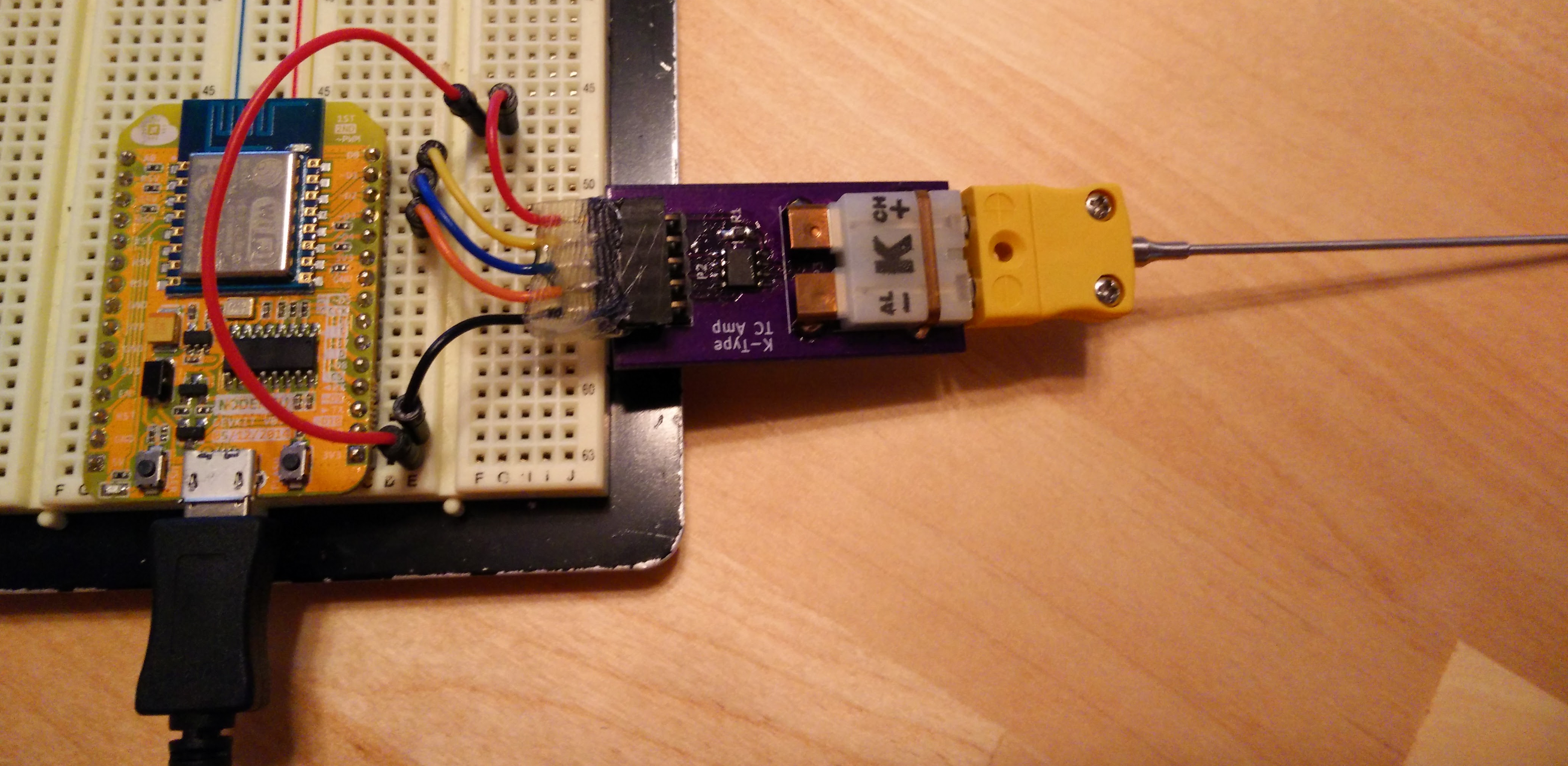

The MAX31855 Thermometer Node
This is the ESP8266 that reads the MAX31855 thermocouple amplifier and broadcasts the temperature to the MQTT network. Since the SPI interface for the MAX31855 requires three GPIO pins (SCK, MISO, and ~CS), it needs to connect to the NodeMCU-Devkit or equivalent ESP-12 breakout board. I chose NodeMCU pins D1, D2, and D3 for the SCK, MISO, ~CS pins respectively. This is a picture of my particular setup:
This node is powered off of the USB cable connected to my computer. If you would like to put this outside, you would need to provide the node with an external power source (and probably an enclosure).
In the rest of the configuration file, we just need to specify names for the pin numbers that the MAX31855 will connect to. Everything else is taken care of in the main function.

    A K-Type Thermocouple Probe and a MAX31855 seems to be overkill for measuring the comfort level. You can do this with a DHT22 much easily but I needed information how to use the MAX31855 with NodeMCU and you have provided all the information that I needed.
    Like. Reply
  • Martin Ziegler December 08, 2015
    Hi Patrick, nice Tutorial…
    Have a tried to build all this not with a NodeMCU but with an ESP-12 only.
    Script works fine, the connection to the MQTT Broker works also good.
    But my MAX sends wrong data. I’ve connected the MAX to the following Pins:
    PIN_SCK = 5
    PIN_MISO = 4
    PIN_CS = 0
    the Result is:
    Published “127.9375” to /data/temp/rj
    Published “2047.75” to /data/temp/tc
    Published “111” to /data/temp/err
    do you (or anybody else) have an Idea ?
    Cheers Martin
    Like. Reply
  • P
    Patrick Lloyd December 08, 2015
    @Tchavdar: Thanks! This is one of those examples of using what’s already in the parts bin vs. going out and buying a new sensor. Originally got the thermocouple for measuring oven temps (~400C).
    @Martin: The error bits that are being transmitted make me think that the proper connections are not being made. If you check the datasheet, all three bits mean there’s a short circuit to ground, a short circuit to vcc and an open circuit which doesn’t make a lot of physical sense. Take special care to ensure that the pins you connected the MAX to are also set up correctly in the config.lua file. The pins may be moved around a bit between the NodeMCU and the ESP-12.
    Like. Reply
