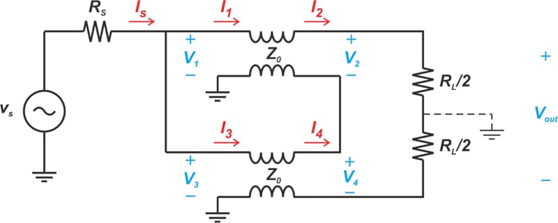

Figure 1 shows a configuration we’re already familiar with—the Guanella 1:4 balun, which incorporates two transmission lines.
The Guanella 1:4 balun.
Figure 1. The Guanella 1:4 balun.

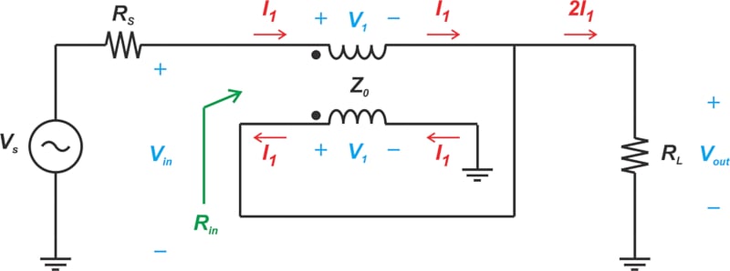

When the balun function isn’t required, we can rearrange a single bifilar coil to provide a 1:4 impedance transformation ratio. Figure 2 depicts this circuit, known as the Ruthroff 1:4 unbalanced-to-unbalanced transformer. You may also see it referred to as the Ruthroff 1:4 “unun,” echoing how we abbreviate “balanced-to-unbalanced transformer” as “balun.” I—like many others—find the term “unun” inelegant and unattractive, and so choose not to use it.
The Ruthroff 1:4 unbalanced-to-unbalanced transformer.
Figure 2. The Ruthroff 1:4 unbalanced-to-unbalanced transformer.
Using the lumped inductor method introduced in the preceding article, let’s analyze this circuit.
Assume that the current through the upper winding is I1 and the voltage drop across it is V1. Due to the transformer action, a voltage difference of V1 is also impressed across the lower winding, and a current of I1 flows through this winding in the indicated direction. The current through the load is therefore equal to 2I1.
Since the lower winding is in parallel with the load, the voltage across the load (Vout) is also equal to V1. The voltage at the input terminal can easily be determined by summing the voltage across the upper winding and the load resistor, leading to:
$$V_{in}~=~V_{1}~+~V_{out}~=2V_{1}$$
Equation 1.
For the load resistor (RL), Ohm’s law defines another relationship between V1 and I1:
$$R_L ~=~ \frac{V_{out}}{2I_1}~=~ \frac{V_1}{2I_1}$$
Equation 2.
We now express the input resistance (Rin) in terms of V1 and I1, using Equation 2 to simplify it:
$$R_{in} ~=~ \frac{V_{in}}{I_1}~=~\frac{2V_1}{I_1}~=~4R_L$$
Equation 3.
The equivalent input resistance is four times the load resistance. To analyze the above circuit more quickly, keep the following in mind:
  • The input voltage is equal to the sum of the voltage drops across the two windings (Vin = V1 + V2).
  • Due to the transformer action, the two voltage drops are equal (V1 = V2).
  • The output voltage is equal to the voltage drop across one of the windings (Vout = V1 = V2).
  • The input voltage is therefore two times the output voltage (Vin = Vout + Vout = 2Vout).
  • A lossless network that changes the voltage by a factor of two produces a 1:4 impedance transformation ratio.

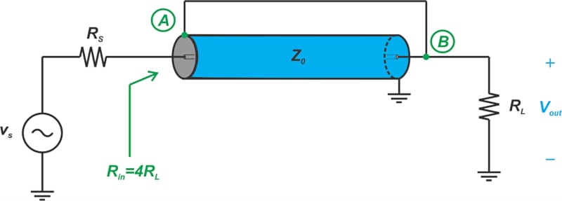

Figure 3 demonstrates a coaxial implementation of the Ruthroff circuit. Note that the coaxial line would usually be loaded with ferrite beads, though these aren’t shown in the figure.
Coaxial implementation of the Ruthroff 1:4 unbalanced-to-unbalanced transformer.
Figure 3. A coaxial realization of the Ruthroff 1:4 unbalanced-to-unbalanced transformer.
For minimal leakage inductance, the distance between points A and B should be as short as possible. This might require bending the line to get the connection points close together. Also note that, in the Ruthroff transformer, the characteristic impedance of the line (Z0) is equal to the geometric mean of the input and output impedances:
$$Z_0 ~=~ \sqrt{R_S R_L}$$
Equation 4.

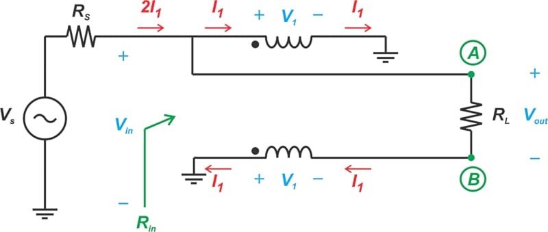

Figure 4 shows the Ruthroff 1:4 balun. Like the unbalanced-to-unbalanced transformer, it’s built around a single bifilar coil.
The Ruthroff 1:4 balun.
Figure 4. The Ruthroff 1:4 balun.
Once again, the same voltage appears across the two windings due to the transformer action. By grounding the appropriate terminals of the windings, voltages with opposite polarities are produced at the load resistor terminals. In other words, nodes A and B have the same voltage with opposite polarities.
It’s easy to see from the circuit diagram that the input voltage is equal to the voltage drop across one winding (Vin = V1), whereas the voltage across the load is Vout = 2V1. The circuit therefore doubles the input voltage, producing a 1:4 impedance transformation ratio. Because the load isn’t grounded at either end, the output is a balanced signal.
