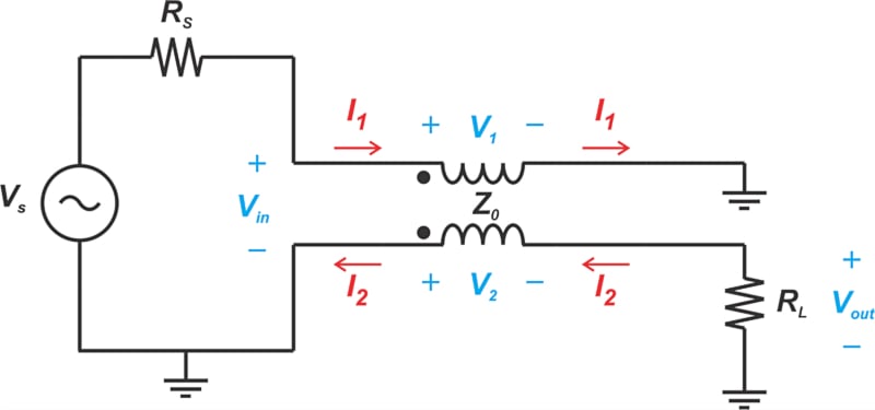

When it comes to analyzing impedance transformation, many books assume that the transmission line transformer behaves similarly to a magnetically coupled transformer. This assumption allows us to avoid the complex math we saw in the preceding section. For example, let’s see what happens if we analyze the phase inverter circuit—reproduced in Figure 3 for ease of reference—as if it were a magnetically coupled transformer.
A broadband phase inverter built with a bifilar coil but analyzed as a magnetically coupled transformer.
Figure 3. Analyzing the broadband phase inverter as a conventional transformer.
In this case, we assume that the voltage across the primary winding (V1) is also impressed across the secondary winding (V1 = V2). Likewise, the same current flows through the primary and secondary windings. To find the polarity of the voltages and the direction of the currents, we apply the transformer dot convention to the figure above. Applying Kirchhoff’s voltage law, we obtain:
$$V_{out}~=~-V_2 ~-~ V_{in} ~+~ V_1 ~=~ - V_{in}$$
Equation 8.
which is consistent with the more precise mathematical analysis we conducted previously.
