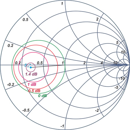

The centers and radii of some constant GS circles are tabulated below.
Table 2. Centers and radii of constant GS circles.
Gain Normalized Gain Center Radius
GS = 0.0 dB gS = 0.71 cS1 = 0.41 ∠ –176.6 rS1 = 0.41
GS = 0.5 dB gS = 0.80 cS1 = 0.45 ∠ –176.6 rS1 = 0.34
GS = 1.0 dB gS = 0.90 cS2 = 0.49 ∠ –176.6 rS2 = 0.23
GS = 1.4 dB gS = 0.99 cS2 = 0.53 ∠ –176.6 rS2 = 0.07
Figure 4 plots these circles in the ΓS plane. The blue dot shows the location of ΓS = S11*.
Constant gain (source) circles for an RF amplifier.
Figure 4. Constant GS circles.
We now have the maximum value of GS. Observe that the centers of the constant GS circles all lie on a line connecting the origin to S11*. As the gain increases, the gain circles become smaller, and the centers of the circles get closer to S11*. Finally, for the maximum value of gain, the gain circle reduces to a single point at S11*.
Note that the GS = 1 (0 dB) circle passes through the origin. This isn’t a coincidence—it always happens for both constant GS and constant GL circles. It’s also worth mentioning that we can choose ΓS to produce a GS less than unity, such as GS = –1 dB.

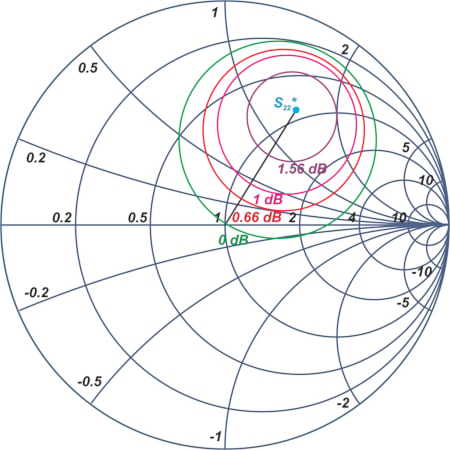

We can find the constant GL circles similarly. Table 3 lists the centers and radii of some example constant GL circles.
Table 3. Centers and radii of constant GL circles.
GL = 0.00 dB gL = 0.64 cL1 = 0.44 ∠ 58.3 rL1 = 0.44
GL = 0.66 dB gL = 0.74 cL1 = 0.49 ∠ 58.3 rL1 = 0.36
GL = 1.00 dB gL = 0.80 cL2 = 0.52 ∠ 58.3 rL2 = 0.31
GL = 1.56 dB gL = 0.91 cL1 = 0.57 ∠ 58.3 rL1 = 0.20
Figure 5 plots these circles in the ΓL plane.
Constant gain (load) circles for an RF amplifier.
Figure 5. Constant GL circles.
Features similar to those mentioned for the constant GS circles are also observable in the constant GL circles.

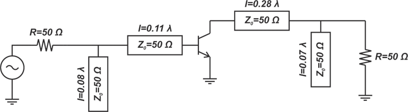

Example 2: Designing Based on Total Gain
Using the results of the previous example, let’s design an amplifier with a gain of 11 dB at 1.4 GHz.
The basic Z0-based transducer power gain of the transistor is G0 = 8.94 dB. Therefore, to have an 11 dB amplifier, the input and output matching sections should provide a total gain of 2.06 dB. One possible solution is to choose GS = 1 dB and GL = 1 dB. The gain circles for this design are shown in Figure 6.
Constant gain circles for an RF amplifier with gain for the source and load both equal to 1 dB.
Figure 6. Constant gain circles for an example amplifier. GS and GL both equal 1 dB.
Any point on these constant gain circles can be used to achieve the desired total gain. We’ll use the reflection coefficient values (ΓS and ΓL) shown in the above figure. Using the Smith chart, we obtain:
ΓS = 0.26 ∠ –176.6
ΓL = 0.22 ∠ 58.3
Figure 7 shows the final design with the input and output matching sections added.
RF amplifier with input and output matching sections added.
Figure 7. RF amplifier with input and output matching sections added.
Though the above diagram shows only the AC amplifier schematic, the amplifier will also require some bias circuitry. Additionally, I’ve assumed that the active device is a bipolar transistor.
Need to brush up on impedance matching techniques? This article on single stub impedance matching can help.
