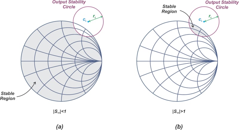

Possible Arrangements For a Potentially Unstable Device
There are several different ways a stability analysis can go wrong. To avoid them, we must exercise care in correctly interpreting the stability circles. In this section, we’ll take a look at some of the different possible arrangements.
When the stability circle intersects the Smith chart, the device is potentially unstable. In the above example, the magnitude of S11 and S22 was less than unity, so the center of the Smith chart produced a stable region of operation. When |S11| > 1 or |S22| > 1, the center of the Smith chart was in the unstable region of operation. Figure 6 shows the ΓL plane for this case.
A pair of diagrams illustrating the stable region in the ΓL plane for values of S11 that are less than 1 (Diagram A) or greater than 1 (Diagram B). In both cases, the output stability circle intersects the Smith chart but doesn't enclose its center.
Figure 6. The stable region in the ΓL plane when either (a) |S11| < 1 or (b) |S11| > 1.
