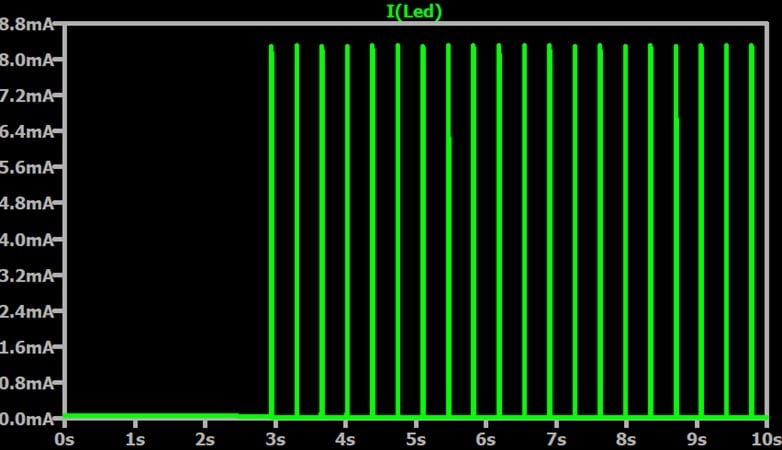

To determine the illumination behavior, we can run a basic transient analysis and plot the current through the LED. This is illustrated in Figure 2.
Current through the LED over a 10 second interval.
Figure 2. Current through the LED over a 10 second interval. Image used courtesy of Robert Keim

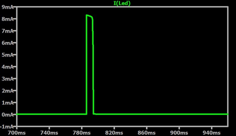

Figure 3 provides a zoomed-in view of the current when the LED is on.
Current through the LED when the LED is on.
Figure 3. Current through the LED when the LED is on. Image used courtesy of Robert Keim
The blink duration is about 7.2 ms and we have about 2.8 blinks per second. Two questions immediately come to mind:

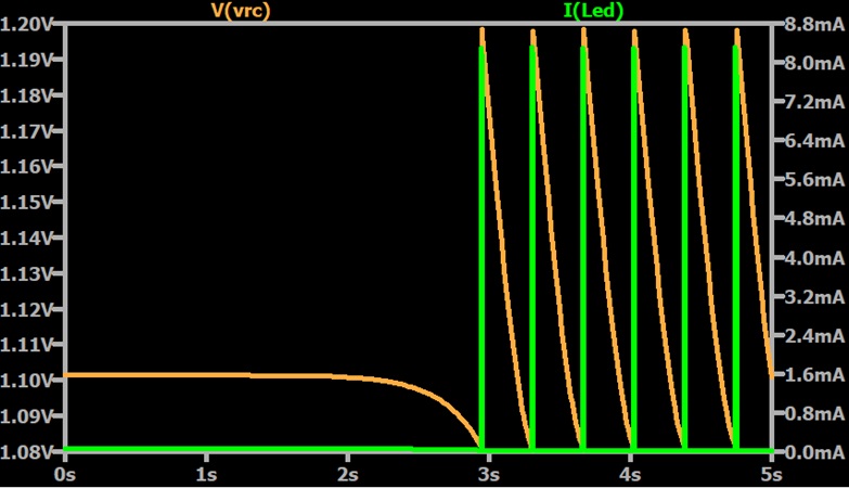

With a delay like that, we should instinctively suspect an energy storage element. To test that suspicion, Figure 4 adds a trace for the voltage across the blinker circuit’s capacitor (C1).
Simulation plot showing the LED forward current and the voltage across the capacitor.
Figure 4. Current through the LED (green trace) and voltage across the capacitor (orange trace). Image used courtesy of Robert Keim
It’s clear from Figure 4 that the capacitor’s voltage is initially non-zero. Blinking only begins once the capacitor has discharged to a certain level. To correct this, we set the initial capacitor charge to zero in LTspice’s component attribute editor. This process is shown in Figure 5.

Figure 6 shows the new simulation results.
Current through the LED with the capacitor’s initial voltage set to zero.
Figure 6. Current through the LED once with the capacitor’s initial voltage set to zero. Image used courtesy of Robert Keim
As you can see, we’ve successfully eliminated the delay.
