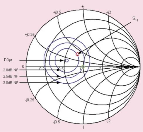

In practice, determining the NF dependence on the source impedance requires specialized noise measurement equipment. This equipment uses stub tuners to apply a range of complex impedances to the device, and these measurements are then analyzed to produce the contours of constant NF on the ΓS plane.
Figure 1 shows the constant NF contours for a hypothetical device. As we’ll shortly discuss in greater detail, these contours are circular in form.
Smith chart demonstrating the impact of driving-point impedance on the noise figure.
Figure 1. Smith chart displaying NF contours of a hypothetical device, demonstrating the impact of driving-point impedance on the noise figure. Image used courtesy of D. Boyd
Note that common noise figure analyzers and network analyzers are not capable of producing these NF contours.

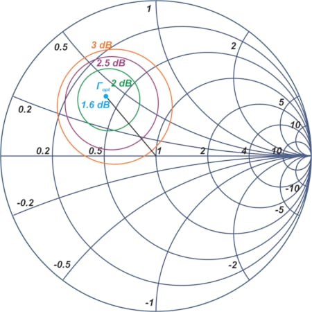

Let’s plot constant NF circles for this transistor at NF = 2 dB, 2.5, dB, and 3 dB. Table 2 summarizes the required calculations. Note that our equations use F, not NF, so we can’t plug the noise figure values into the equations directly. Instead, we have to convert them from decibel measurements to the linear terms in which the noise factor is expressed.
Table 2. These calculation results allow us to plot constant NF circles for our example transistor.
NF F N cF rF
2.0 dB 1.58 0.05 0.47 ∠ 130 degrees 0.20
2.5 dB 1.78 0.13 0.44 ∠ 130 degrees 0.30
3.0 dB 2.00 0.21 0.41 ∠ 130 degrees 0.37
These constant NF circles are plotted in Figure 2.
Constant NF circles for an example transistor.
Figure 2. Constant NF circles for an example transistor. Image used courtesy of Steve Arar
Note that the centers of the constant noise circles lie on the line drawn from the center of the Smith chart to the point Γopt (see Equation 6). At Γopt, where we obtain NFmin = 1.6 dB, the noise circle transforms to a single point. As we increase the noise figure, the center of the circle moves closer to the origin, and its radius becomes larger.

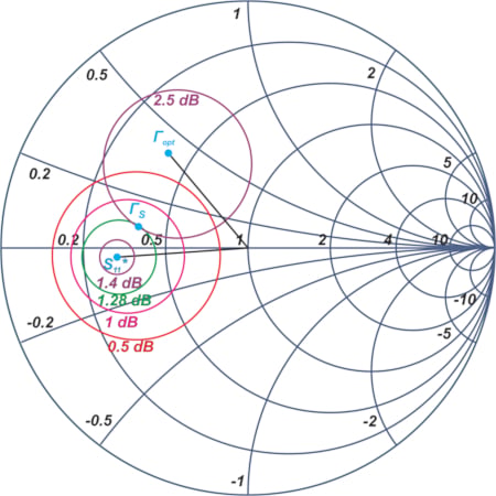

Figure 3 plots these circles and the NF = 2.5 dB circle in the ΓS plane.
Constant GS and NF circles for an example low-noise amplifier.
Figure 3. Constant GS and NF circles in the ΓS plane. Image used courtesy of Steve Arar
The GS = 1.28 dB gain circle only intersects the noise circle of NF = 2.5 dB at ΓS = 0.45 ∠ 169.17 degrees. Any higher value of GS will move us away from Γopt, resulting in a larger noise figure.
