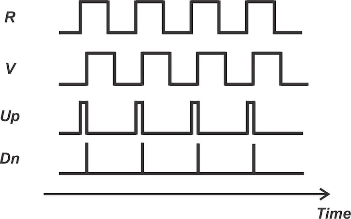

Figure 2 shows the typical waveforms of this PFD when the inputs (R and V) are at the same frequency but have a non-zero phase difference.
Typical waveforms with a non-zero phase difference.
Figure 2. Typical waveforms of the PFD when both inputs are at the same frequency and there is a phase difference.
In this situation, the Dn output produces narrow pulses. This happens because when Dn transitions to a HIGH state, the Up and Dn outputs are both at a logic HIGH, which triggers the AND gate in the reset path.
The Dn output remains HIGH until the flip-flops are reset. The HIGH pulse width of Dn is equal to the total delay of the AND gate plus the reset operation delay of the flip-flops. If the reset path operates too quickly, the pulses may become too narrow for the subsequent stage to function properly. To ensure the PFD operates correctly, it is therefore essential to introduce an appropriate delay in the feedback path.

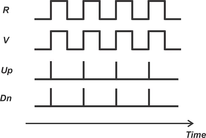

Above, we had a non-zero phase difference between R and V. Figure 3 shows the typical waveforms when this phase difference is negligible.
Typical waveforms when the inputs are in phase alignment.
Figure 3. Typical waveforms when the R and V pulses are in phase alignment.
As you can see, we now have runt pulses at both Up and Dn outputs. Since runt pulses can't properly drive the subsequent circuits, we can conclude from these waveforms that a fast feedback path negatively impacts circuit performance near the locking point. Once again, the issue can be resolved by deliberately extending the reset path delay to widen the output pulses.
It's worth mentioning that the short pulses that appear at the Up and Dn outputs near the locking point result in ripples on the VCO control voltage. However, the ripple energy is low, and its spectrum covers a broad bandwidth in comparison to the ripple pulses produced by other phase detectors (the multiplier detector, for example). These properties make ripple suppression significantly easier.

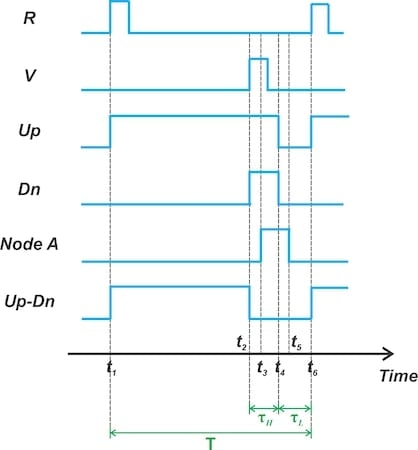

To understand how delays in the PFD feedback path affect the circuit's operation, let's consider the waveforms in Figure 4.
The effect of gate delays on the PFD waveforms.
Figure 4. The effect of gate delays on the PFD waveforms.
At time t = t1, a rising edge is detected on the R input. Assuming the flip-flop delay from the R input to the output is negligible, the Up output also rises to a HIGH state at t = t1.
Subsequently, at t = t2, a rising edge appears on the V input. Neglecting the flip-flop delay from the V input to the output, the Dn output transitions to HIGH at t = t2 as well.
At this point, both the Up and Dn outputs are HIGH, triggering the AND gate to produce a reset signal at node A. However, it takes time—the delay of the AND gate—for the reset pulse to reach a HIGH state. Once the reset pulse goes HIGH at t = t3, the flip-flop requires additional time to reset the output, which occurs at t = t4. Hence, the time duration τH shown in the figure is equal to the propagation delay of the AND gate plus that of the flip-flop from the reset input to the output.
The Up-Dn waveform at the bottom of Figure 4 represents the PFD's final output, which is derived by subtracting the Dn output from the Up output. This waveform shows that for a non-zero time duration of τ = τL + τH, the final output is at a LOW state.
A key point here is that once the outputs are reset, they cannot immediately transition to a logic HIGH in response to a rising edge at the inputs. In other words, the value of τL cannot be zero. To understand this, note that when both outputs are reset at t = t4, the AND gate works to bring the reset signal at node A down to a logic LOW. Due to the delay of the AND gate, this can't happen immediately.
Additionally, once the reset pulse goes LOW at t = t5, the flip-flop needs some extra time to recover from the reset before it is ready to detect upcoming rising edges at the inputs. The minimum value of τL is therefore equal to the propagation delay of the AND gate plus the recovery time of the flip-flop from a reset.

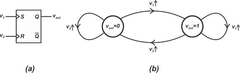

Earlier in this article series, we learned that the RS flip-flop phase detector can be modeled as a two-state device. Its state diagram is illustrated in Figure 5.
The RS flip-flop phase detector (left) and its equivalent state diagram (right).
Figure 5. The RS flip-flop phase detector (a) and its equivalent state machine (b).

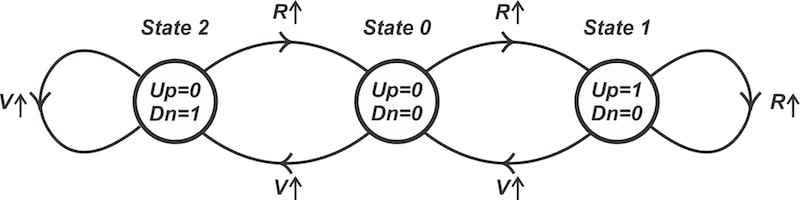

The PFD can likewise be modeled by a state machine. A cursory analysis shows that the PFD is equivalent to a state machine with at least three distinct states:
  • State 0: Up = 0, Dn = 0.
  • State 1: Up = 1, Dn = 0.
  • State 2: Up = 0, Dn = 1.
This is illustrated in Figure 6.
State diagram of the PFD.
Figure 6. The state diagram of the PFD circuit.
When the PFD is in state 0 (Up = 0, Dn = 0), a rising edge on input R transitions the system to state 1 (Up = 1, Dn = 0). The circuit stays in this state until a rising edge on input V resets the flip-flops, returning the system to state 0.
As Figure 6 illustrates, a rising edge on input V causes the system to shift from state 0 to state 2 (Up = 0, Dn = 1). The circuit remains in this state until a rising edge on input R resets the flip-flops, bringing the system back to state 0 (Up = 0 and Dn = 0).
It's important to recognize that the state diagram above is only a basic model of the system. As illustrated in Figure 4, both the Up and Dn outputs can briefly be HIGH at the same time. Consequently, a more precise representation of the system would incorporate a fourth state where Up = 1 and Dn = 1.
