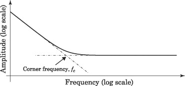

1/f Noise
Also known as pink or flicker noise, the exact origin of 1/f noise has not been exactly found, but it is well characterized in different components.
The amount of noise is inversely proportional to the frequency. That's why it can be difficult to perform accurate measurements on low-frequency experiments.
Power spectral density (PSD) of flicker noise
Power spectral density (PSD) of flicker noise. Image used courtesy of Behraad Bahreyni [2]
Pink noise presents a corner frequency fc, from where the noise is uniform. This frequency depends on the nature of each component (resistors, diodes, transistors, etc.).
