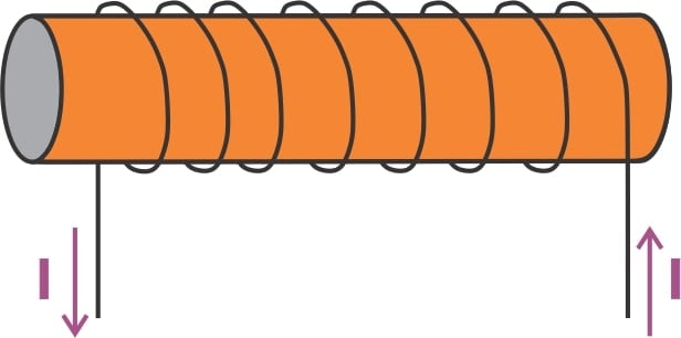

Example: Magnetic Field Intensity of a Solenoid
Consider the solenoid in Figure 1.
An example solenoid with N turns and a length of l.
Figure 1. An example solenoid. Image used courtesy of Steve Arar
We want to answer two questions:
  1. What is the magnetic flux density (B) and the magnetic field intensity (H) of this solenoid when a core isn’t used?
  2. How does the flux density change when we insert a core with relative permeability μr?
Assuming that the turns are closely spaced and the field inside the coil is uniform, we can apply Ampere’s law to find the field inside the coil. Without going through the steps in detail, the end result for an air-core solenoid is:
$$\overrightarrow{B} ~=~ \mu_0 \frac{N}{l} I ~=~ \mu_0 n I$$
Equation 4.
where:
N is the total number of turns
l is the length of the solenoid
I is the current
n is the number of turns per unit length.
Because no magnetic core is being used, the magnetic field described in Equation 4 arises from the current through the coil without any contribution from core magnetization (B = B0). Dividing this value by μ0 gives us the magnetic field intensity:
$$\overrightarrow{H} ~=~ \frac{\overrightarrow{B}}{\mu_0} ~=~ \frac{\mu_0nI}{\mu_0} ~=~ nI$$
Equation 5.
If we insert a core, the magnetic flux density becomes:
$$\overrightarrow{B}~=~\mu_{0} \mu_{r} \overrightarrow{H}~=~\mu_{0} \mu_{r} n I$$
Equation 6.
Due to the presence of the core, B now includes two magnetic field components:
  • The magnetic field created by the electric current.
  • The magnetic field created by the magnetization of the core material.
The magnetic field intensity, which itself is produced by electric currents, can therefore be thought of as the driving force that produces the magnetic flux density. Permeability quantifies the ease with which H gives rise to B.

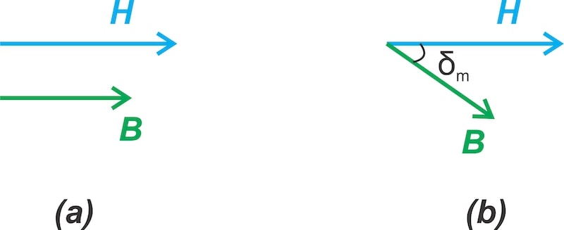

Magnetization Out of Phase With Applied Field
We defined complex permeability in Equation 11. Let’s see what that equation really means.
We know that permeability describes the relationship between the external field applied to a magnetic material and the field produced inside of it. The real part of the permeability in Equation 11 corresponds to the material magnetization that occurs in phase with the external field. This is the behavior that we expect from an ideal, lossless core.
On the other hand, the imaginary part of the permeability shows that some magnetization of the material occurs 90 degrees out of phase with the applied field. This phase shift leads to an induced voltage across the inductor that’s in phase with the current flowing through the circuit, producing a resistive term in the overall impedance equation.
Figure 3 shows the phase relationship between B and H fields for two different cores. Figure 3(a) corresponds to a lossless core, Figure 3(b) to a lossy one.
The phase relationship between B and H.
Figure 3. The phase relationship between the B and H fields. Image used courtesy of Steve Arar
In the lossless core, \(\overrightarrow{B}\) is in phase with \(\overrightarrow{H}\). In the lossy core, however, the total field inside the material lags the magnetic field intensity. The phase lag of \(\overrightarrow{B}\) with respect to \(\overrightarrow{H}\) is called the loss angle. As we see in the above figure, it’s symbolized by δm.
The tangent of the loss angle is given by:
$$\tan(\delta_m) ~=~ \frac{\mu_r''}{\mu_r'}$$
Equation 13.
The loss tangent is also the ratio of a coil’s equivalent series resistance (neglecting copper resistance) to its reactance. This ratio is equal to the reciprocal of the inductance’s quality factor (Q), giving us:
$$\tan(\delta_m) ~=~ \frac{R}{\omega L}~=~\frac{1}{Q}$$
Equation 14.
