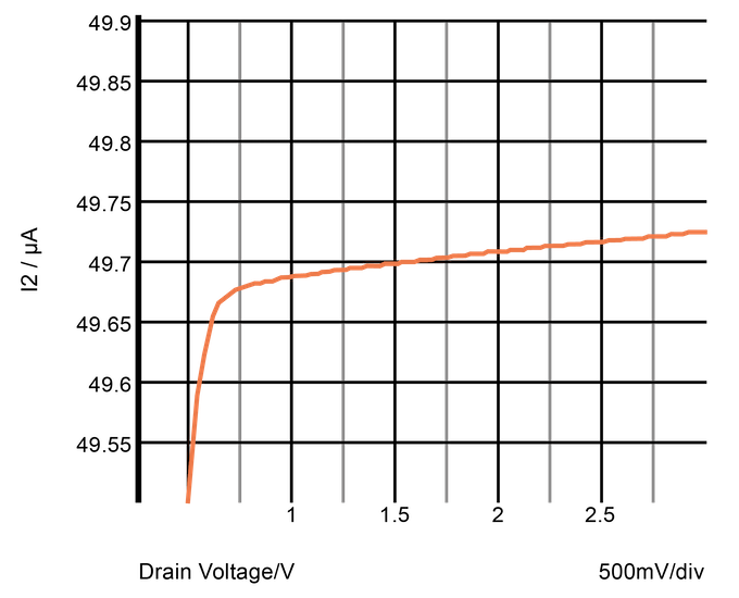

Here M3 and M5 simply shield M2 and M4 from changes in the output voltage. Their gates are held at a voltage slightly higher than the threshold voltage of M1 by causing a voltage drop in R1.
In our case here, this bias voltage is 500 mV, which results in quite a remarkable performance, as illustrated in Figure 4-21, but requires at least 0.7 V at the output. Lowering the voltage drop across R1 lowers this minimum output voltage but increases the voltage dependence, which you can reduce again using even larger devices.
Current vs collector voltage graph for a cascode MOS current mirror.
Figure 4-21. Performance of cascode MOS current mirror.

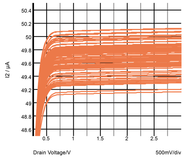

Again, don't get carried away by the impressive performance shown with the single sweep shown in Figure 4-21, which assumes perfect matching. A Monte Carlo run will show you the true behavior (Figure 4-22).
Current vs collector voltage Monte Carlo simulation of a cascode MOS
current mirror.
Figure 4-22. Monte Carlo simulation of the cascode MOS current mirror.

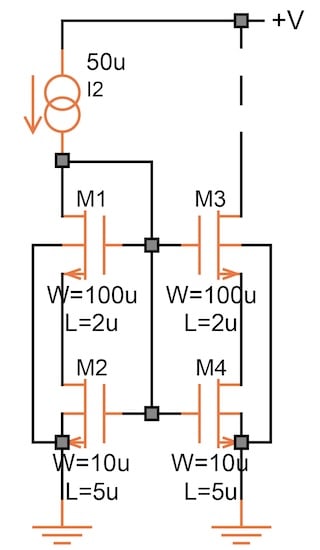

For CMOS current mirrors, there are three more sophisticated schemes. Figure 4-23 is the one you frequently see in articles.
Circuit schematic for a widely used MOS current mirrors
Figure 4-23. Widely used MOS current mirror.
M1 is a thin device, producing a bias voltage about 100 to 200 mV higher than the gate voltages of M3 and M5. Since the gates of M2 and M4 are connected to this point, these two devices act as cascodes, i.e., they shield the lower two devices from voltage changes.

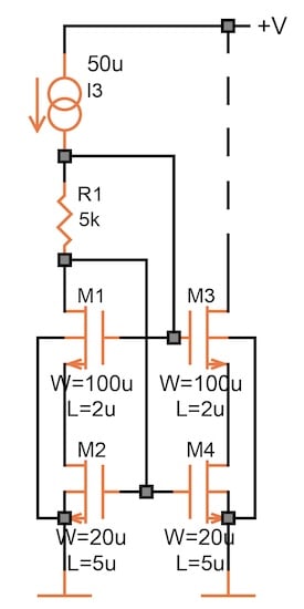

Alternatively, the circuit in Figure 4-24 using the dimensions shown has exactly the same performance with fewer devices and less current consumption. Here the lower devices are dimensioned so that the gate voltage (at 50 μA) has the required value for cascode biasing.
Circuit schematic for an improved MOS current mirror with fewer
transistors
Figure 4-24. A MOS current mirror with fewer devices that provides the same performance.
The upper devices are then made wide enough to leave a comfortable margin between their source potentials and the "on" voltage of the lower devices (i.e., the voltage drop caused by channel resistance). This is a prime example of how much you can do by simply changing the channel length and width of a CMOS transistor.

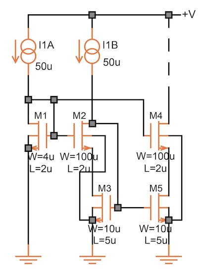

The circuit in Figure 4-25 has the best performance. The cascode bias voltage is set not only by the device dimensions but by the small (250 mV) voltage drop across R1. Since the current itself is almost certainly determined by a resistor, R1 will track it.
Circuit schematic for a MOS current mirror with the best performance
Figure 4-25. A MOS current mirror with the best performance.

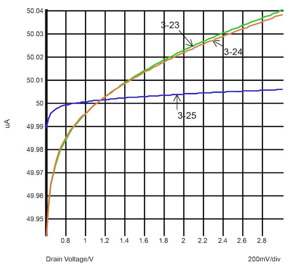

The flatter curve shown in Figure 4-26 represents a higher output impedance (100 MΩ for the circuit of Figure 4-25, 33 MΩ for the circuits of Figures 4-23 and 4-24) which is important for high gain in active loads.
Current vs collector voltage graph comparing performance for three MOS
current mirrors.
Figure 4-26. MOS current mirror performance comparison.
