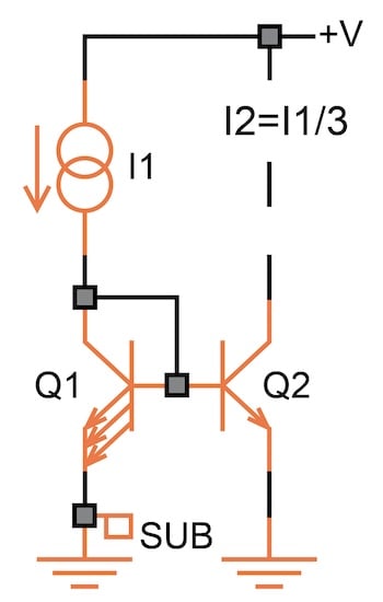

In Figure 4-16, Q1 has three emitters, and Q1 has one, causing I2 to have one-third the value of I1. Any ratio is possible (such as 3:2 or 5:3).
Circuit schematic for a simple NPN current mirror with a 3:1 current
ratio
Figure 4-16. A simple current mirror with a 3:1 current ratio.

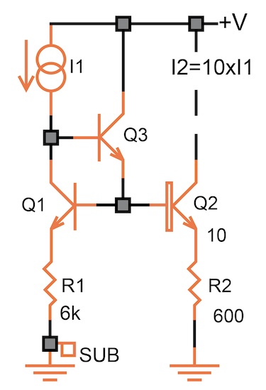

Adding an Extra Transistor to Supply the Base Currents
There’s a solution to this (you may have noticed that there’s always a solution—it just takes one, or a few, additional transistors). As shown in Figure 4-18, with the help of Q3, the base current for Q1 and Q2 is supplied not from I1 but from the positive supply. The base current error is therefore divided by the gain of Q3. In this way, you can not only create large current ratios but also drive a substantial number of separate transistors.
Circuit schematic demonstrating an additional transistor to supply
base currents.
Figure 4-18. Adding an additional transistor, Q3, to supply the base currents.
In Figure 4-18, emitter resistors are also used to get less of a change in I2 with a varying output voltage (0.7% from 0.7 V to 5 V). If you have 10 separate transistors, they all get 6 kΩ in the emitter. If the current is simply multiplied by 10, R2 has one-tenth the value of R1.
Remember that the best matching is achieved if the resistors consist of identical sections. For example, you’d create a 600 Ω unit resistor and use one resistor for Q2 and 10 unit resistors in series for Q1.
If you’re thinking of turning I1 on and off rapidly, be aware that this circuit is very slow to turn off—there’s no discharge path for the bases of Q1 and Q2. A resistor (or another current sink) from these bases to ground helps to speed up the turn-off time.
