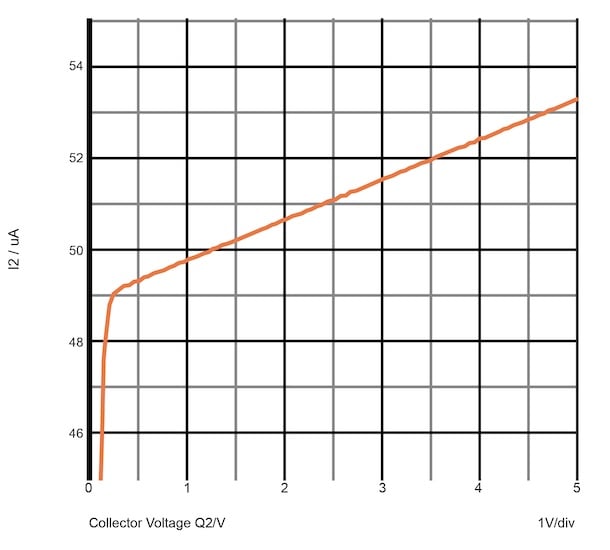

The two transistors may be identical, but assuming that they’re operated identically is error number two. The collector voltage of Q1 is always VBE, but the collector voltage of Q2 may be anything. As we know from the discussion of the performance limitations of bipolar transistors in the Analog Devices chapter, the gain is affected by the collector voltage. Due to the Early effect, it increases as the collector voltage increases. Thus I2 isn’t exactly steady, as Figure 4-2 illustrates.
Current vs collector voltage graph for a simple NPN bipolar current
mirror
Figure 4-2. Current vs. collector voltage for a simple bipolar current mirror.
In Figure 4-2 (and all other simulation examples in this chapter), the current reference I1 is 50 μA. For this particular transistor, which is made in a process capable of 20 V, I2 changes by 8% over the range of the collector voltage. It increases from about 49 μA at 0.3 V, which is the saturation voltage of Q2, to about 53 μA at 5 V.

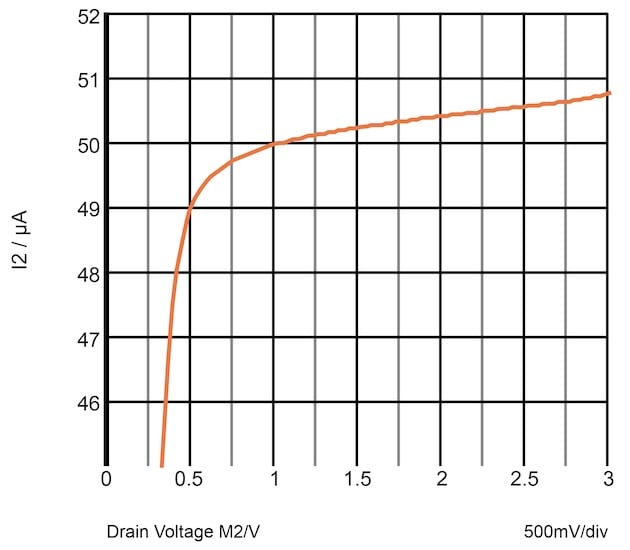

Figure 4-6 shows the voltage dependence of the MOS current mirror in Figure 4-5.
Current vs collector voltage graph for the simple MOS current mirror
Figure 4-6. The voltage dependence of the simple MOS current mirror.
The voltage dependence can be reduced by increasing the channel lengths of the MOSFETs. Figure 4-6 shows only about a 1.5% change in current over the 1 V to 3 V range of the drain voltage for this 0.35 μm process. However, that’s because the channel lengths were made quite large.
It takes at least 0.5 V at the drain of M2 to make the mirror work, a figure which you can improve by making the devices much wider. The mirror can be inverted by using P-channel devices.
