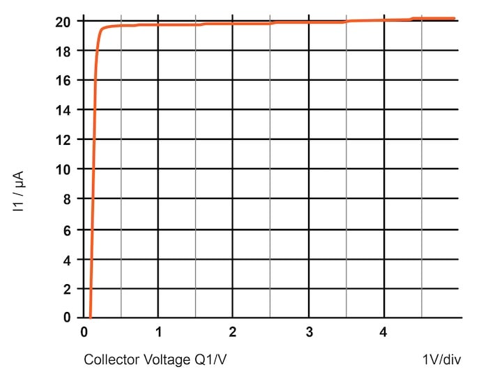

The voltage at the collector of Q1 can now go lower, to the saturation voltage of the device plus the ΔVBE.
There is little change in current as the voltage at the output changes (Figure 6-8). The impedance is about 12 MΩ.

Figure 6-8. Output current (I1) vs. output voltage for the ΔVBE current source.

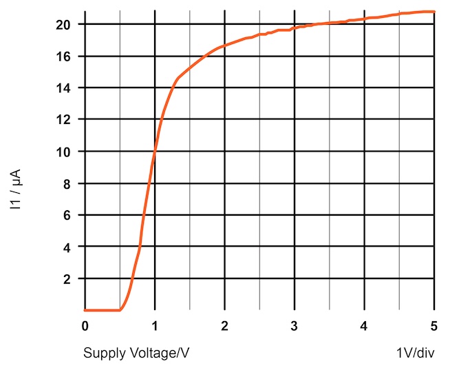

However, as shown in Figure 6-9, the dependence on the supply voltage is quite large, a +6.5% change as Vcc moves from 4.5 to 5.5V.

Figure 6-9. Output current (I1) vs. supply voltage for the ΔVBE current source.

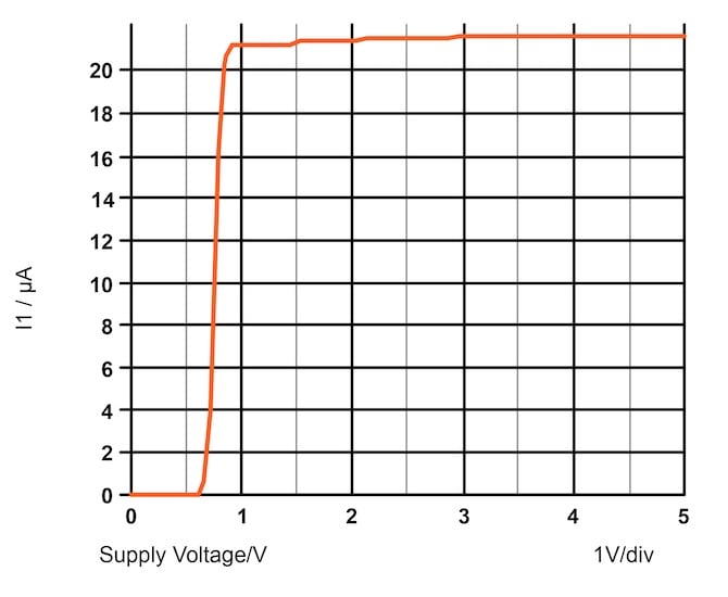

R1 has been added to counteract the remaining dependence on Vcc (caused by the Early effect in Q2 and Q3). With that, we get a change of +0.4% as Vcc increases from 4.5 to 5.5V. The circuit can have a supply voltage as low as 1 V (Figure 6-13), and the voltage at the output can be as low as 0.3 V.

Figure 6-13. Output current (I1) vs. supply voltage for the self-starting current source.

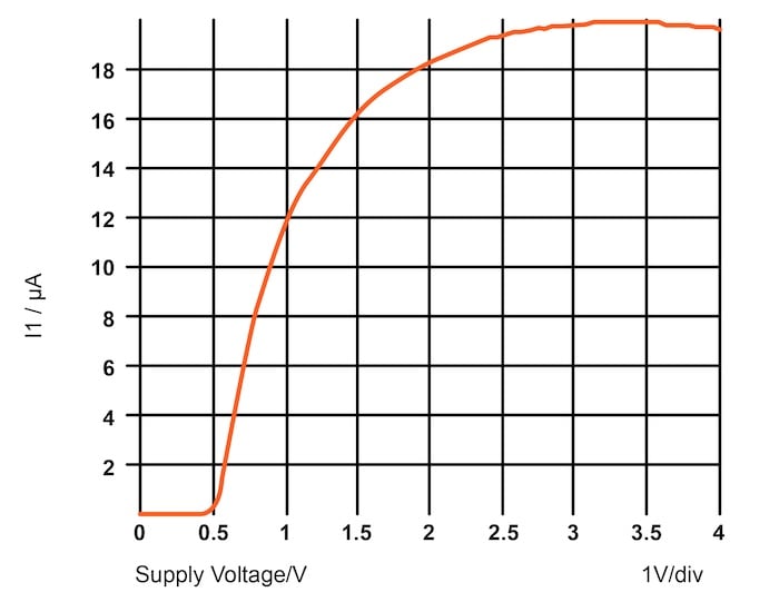

Vcc can be as low as 1 V or as high as breakdown voltages allow (Figure 6-15). Moving Vcc 20% changes I1 by 0.08%. The output impedance is 50 MΩ.

Figure 6-15. Output current (I1) vs. output and supply voltage for the Erdi current source.
