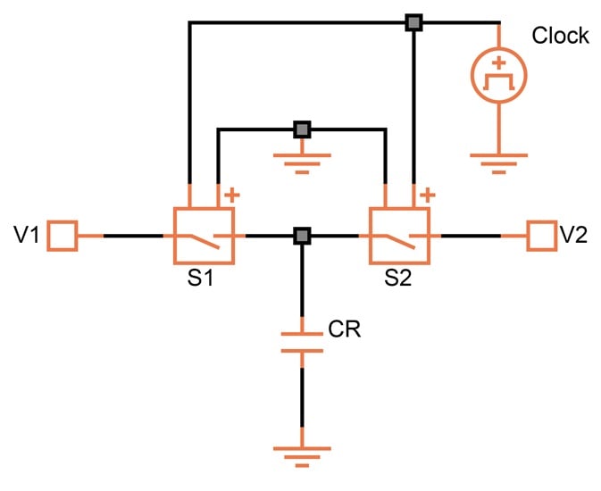

Figure 15-20 shows how rapid switching can cause a capacitor to act like a resistor.
Making a resistor out of a capacitor by switching at a rapid rate.
Figure 15-20. Making a resistor out of a capacitor by switching at a rapid rate.
If we charge a capacitor (CR) by closing switch S1 for a brief period of time, the potential across the capacitor is V1. Then, if we open S1 and close S2 for the same amount of time, the potential across the capacitor is V2.
The charge in a capacitor (in Coulombs) is given by either the capacitance times the voltage or the current flowing into the capacitor for a certain period of time. This is one of the handiest formulae to carry in your mind:
$$Q~=~C ~\times~ V ~=~ I~ \times ~t$$
In the case of Figure 15-20, the current flowing between the two terminals over one period is:
$$I ~=~ \frac {C_R (V_1~-~V_2)}{t_{clock}} ~=~ C_R (V_1~-~V_2) ~\times~ f_ {clock}$$
If we had a resistor between V1 and V2 instead of the switches and the capacitor, the current flowing through it would be:
$$I ~=~ \frac {V_1~-~V_2}{R}$$
Thus, the equivalent resistance of the switched capacitor is:
$$R ~=~ \frac {1}{C_R~\times~ f_{clock}}$$
Let's look at some numbers. Suppose the switching frequency is 100 kHz and CR = 5 pF:
$$R ~=~ \frac {1}{10^5~\times~5~\times~10^{-12}} ~=~ 2~\times~10^6 ~=~ 2 \ \text{M} \Omega$$
With a relatively small capacitor, we can create the equivalent of a large-value resistor. If we were to implement such a device directly, the cost in area would be prohibitive.

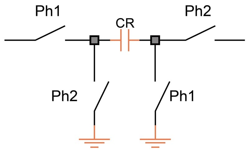

Minimizing Stray Capacitance
To minimize the influence of stray capacitances, four CMOS switches are often used instead of just two. The result, shown in Figure 15-22, is an inverting configuration.
Switch configuration meant to minimize the effect of stray capacitances in CMOS.
Figure 15-22. Switch configuration meant to minimize the effect of stray capacitances in CMOS.
For either switch design, it is important that the two lateral switches never be closed at the same time. There must be some dead time between the two phases (Ph1 and Ph2) of the clock.
