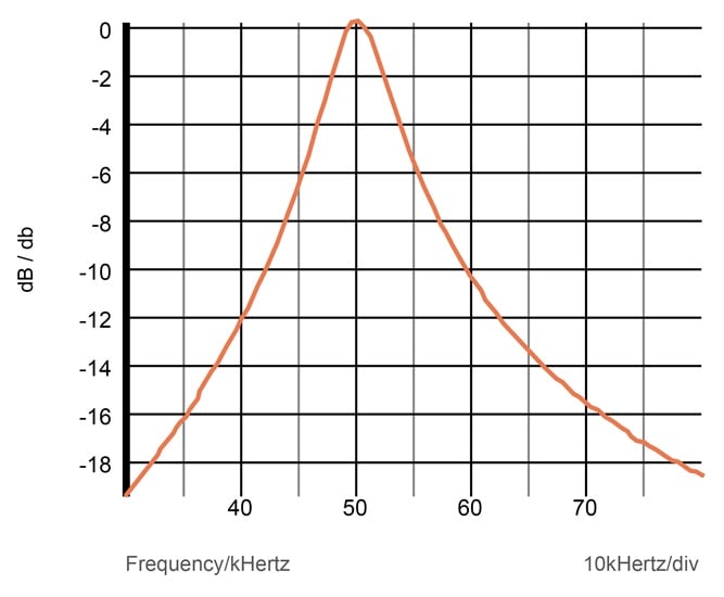

As Figure 15-17 shows, we now have a drop-off in amplitude at both high and low frequencies.
Second-order band-pass filter response.
Figure 15-17. Second-order band-pass filter response.
Although the arrangement is called a second-order band-pass filter, the drop-off rate is only first-order (20 dB per decade) since only one pole is active in each frequency segment. We can, of course, improve this by adding more stages. Each stage contributes another 20 dB per decade drop-off.

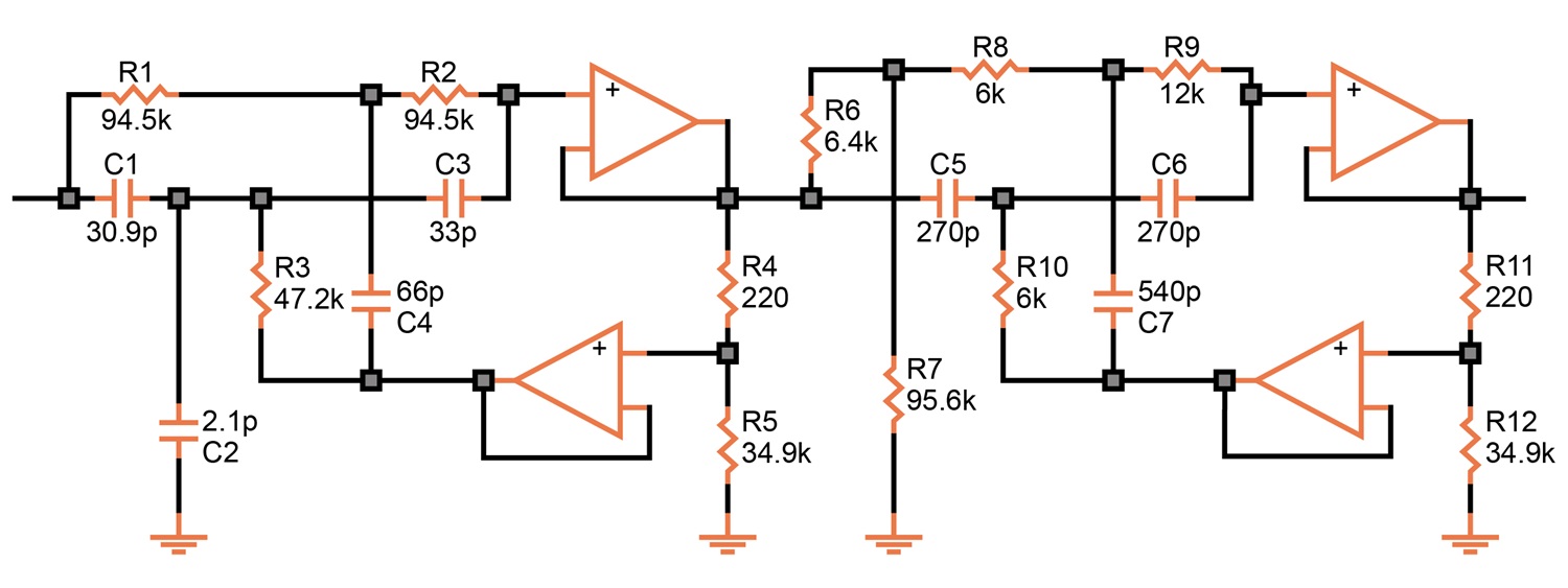

We can implement an elliptic band-pass filter using two Twin-T stages. This is illustrated in Figure 15-18.
A fourth-order Twin-T elliptic band-pass filter.
Figure 15-18. [click to enlarge] A fourth-order, Twin-T, elliptic band-pass filter.

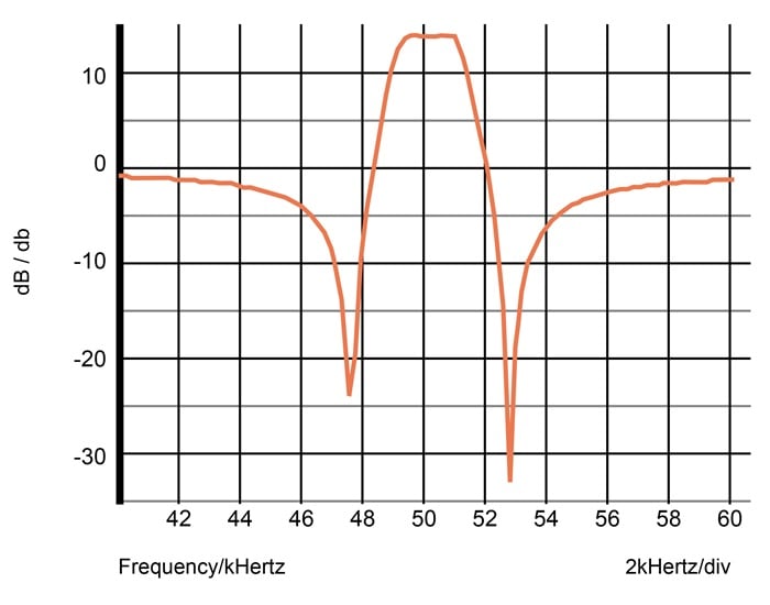

The first stage is a second-order low-pass notch configuration. The second stage is a second-order high-pass notch filter. Figure 15-19 shows the frequency response of this filter, which has a center frequency of 50 kHz and a bandwidth of 2 kHz.
Response of a fourth-order elliptic band-pass filter.
Figure 15-19. Response of a fourth-order elliptic band-pass filter.
Just outside the passband, the attenuation reaches its maximum. However, it then settles down to a modest 15 dB.
