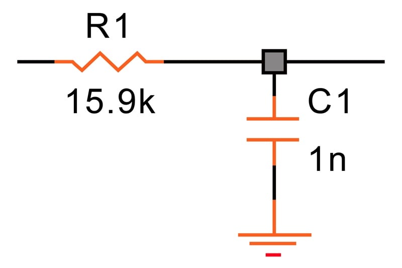

Let's start by considering a simple RC network (Figure 15-1).
Single-pole RC low-pass filter.
Figure 15-1. Single-pole RC low-pass filter.
This filter has a cutoff frequency (the point at which the amplitude drops by 3 dB) of:
$$f_{3dB} ~=~ \frac {1}{2\pi RC}$$
For the values shown in Figure 15-1, the cutoff frequency is 10 kHz. We can confirm this by examining Figure 15-2, which shows the filter's frequency response. If you extend the straight portion of the curve in Figure 15-2 upward, it points precisely to 10 kHz.

Below about 1 kHz, there is no attenuation. At 10 kHz, the signal at the output is down by 3 dB. At 100 kHz (10 times f3dB), the attenuation is 20 dB.
Such a single-pole, passive filter is said to have an attenuation of 20 dB per decade or 6 dB per octave. An octave represents a doubling of the frequency.

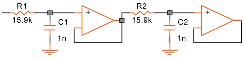

We don't need to be satisfied with just one RC network. Instead, we can connect several of them in series (i.e., cascade them). As illustrated in Figure 15-3, however, we need to put a buffer in between the stages. Otherwise, each succeeding network will load down the previous one too much.

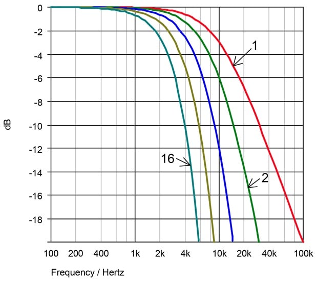

However, this is a poor way to sharpen the filter response. The second stage will roll off faster, but it also lowers the 3 dB frequency. This can be seen in Figure 15-4.
Placing identical low-pass stages in series lowers the cutoff frequency.
Figure 15-4. Placing identical low-pass stages in series lowers the cutoff frequency.
The more stages there are in series, the lower the cutoff frequency. With 16 stages, it has moved down to a little over 2 kHz.
