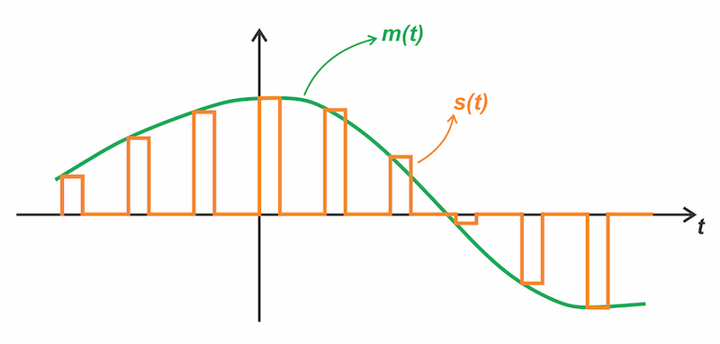

Flat‑top PAM produces a train of pulses whose amplitudes follow the sampled values of the message signal. Figure 1 illustrates a representative message signal alongside its corresponding flat‑top PAM waveform.
Figure 1. Message signal (green) and the corresponding PAM waveform
(orange).
Figure 1. Message signal (green) and the corresponding PAM waveform (orange).

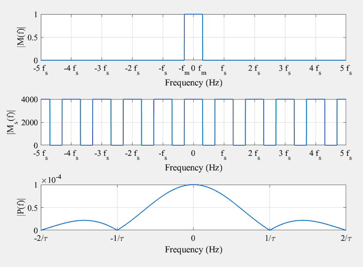

For illustration, let’s take m(t) to have a flat spectrum extending from DC up to fm, as shown in the top sub‑figure of Figure 3.
Figure 3. Magnitudes of the Fourier transforms of the message m(t)
(top), its instantaneously sampled version ms(t) (middle), and the
unit‑amplitude pulse p(t) (bottom).
Figure 3. Magnitudes of the Fourier transforms of the message m(t) (top), its instantaneously sampled version ms(t) (middle), and the unit‑amplitude pulse p(t) (bottom).

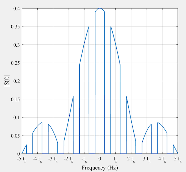

The spectrum of the instantaneously sampled signal ms(t) comprises replicas of the original message spectrum, as illustrated in the middle sub‑figure. The bottom sub-figure shows the spectrum of p(t) for a pulse duration of τ = 100 ms. Note that the sinc function crosses zero at frequencies f = ±k / τ for all non-zero integers k. Multiplying Ms(f) with P(f) produces the spectrum of the modulated signal s(t), as shown in Figure 4.
Figure 4. The spectrum of the flat-top PAM signal.

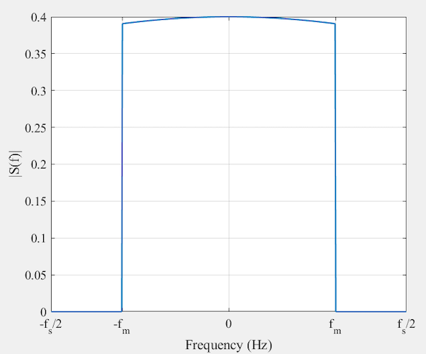

Figure 5 provides a closer view of the flat‑top PAM spectrum, focusing on the frequency range below fs / 2.
Figure 5. Zoomed‑in view of the flat‑top PAM spectrum, showing the
frequency components below fs/2.
Figure 5. Zoomed‑in view of the flat‑top PAM spectrum, showing the frequency components below fs/2.
As observed, a replica of the message spectrum appears in the baseband region. However, the higher frequencies of the spectrum experience greater attenuation relative to those near DC. It is clear that the receiver can readily recover the message by applying a low‑pass filter with appropriate cut-off frequency to isolate the baseband component, provided the distortion is not severe.

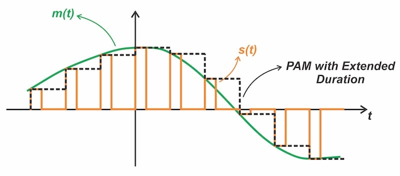

This shows that an excessively short pulse duration τ can result in unacceptably low amplitude in the recovered message signal. A sample-and-hold circuit mitigates this issue by extending the pulse width to increase the signal level, providing effective amplification while circumventing the noise associated with additional active gain stages. Figure 8 illustrates the pulse-width extension provided by the sample-and-hold circuit.
Figure 8. Pulse-width extension using a sample-and-hold circuit.
The waveform above holds the value of each pulse until the next pulse appears. Because the aperture effect distortion grows with pulse duration, we can also opt for a smaller increment in the pulse duration to ease equalization.
Before moving forward, note that the sample-and-hold switch in Figure 7 operates synchronously with the incoming pulse train: it closes with a short delay following the pulse leading edge and opens prior to the trailing edge. Furthermore, the amplifier preceding the sampling switch is configured as a buffer to drive the sample-and-hold circuit, and its gain is incidental to the core operation discussed here.

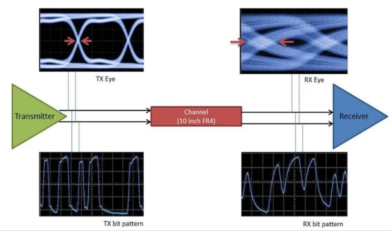

Before we conclude, I want to highlight an important phenomenon related to transmitting pulses through communication channels. When a rectangular pulse passes through real-world filters and channels, the finite bandwidth of the system slows down the pulse transitions. As the pulse spreads out in time, some of its energy leaks beyond the intended duration. Due to this smearing effect, the decaying tail of one pulse may interfere with subsequent pulses, causing a distortion known as intersymbol interference (ISI). To understand this, consider transmission of a bit stream through a long PCB trace, as illustrated in Figure 9.
Figure 9. The effect of elongated rise/fall times on the transmission
of a bit stream. Image used courtesy of TI.
Figure 9. The effect of elongated rise/fall times on the transmission of a bit stream. Image used courtesy of TI.
While the signal transitions are sharp at the transmitter side, they slow down, as the signal travels to the far end of the transmission line. When several consecutive bits have the same value, the received signal can reach its final value despite the elongated rise and fall times. However, in a bit stream that alternates between 1s and 0s, like 101010101, the transmitted pulses are shorter, and the output doesn't have enough time to reach its final value. Thus, whether a transition reaches its final value depends on the bit pattern.
To mitigate this distortion, systems use pulse shaping filters to reshape the waveform, allowing it to fit within the channel’s available bandwidth while controlling ISI. Common options for minimizing ISI include raised cosine and root-raised cosine pulses. In a future article, we will explore the ISI effect in greater detail and learn more about pulse shaping.
