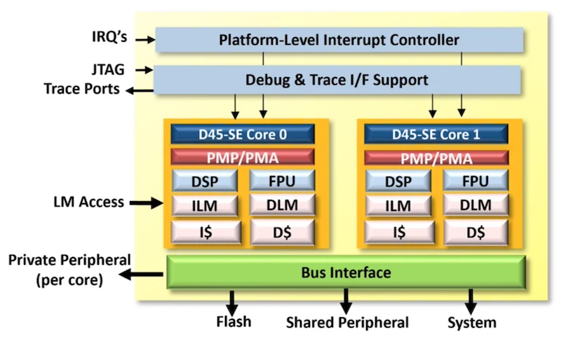

1. Andes Technology Invests in Automotive Safety
At the show, Andes launched a new automotive RISC-V processor, the AndesCore D45-SE, targeting ISO 26262 ASIL-D (Automotive Safety Integrity Level D) certification.
Block diagram of AndesCore D45-SE
Block diagram of AndesCore D45-SE. Image used courtesy of Andes Technology
The AndesCore D45-SE is a 32-bit, eight-stage and dual-issue RISC-V processor. The chip is an outgrowth of the in-production D45 processor that has been enhanced for automotive applications. The processor supports RISC-V GCBP extensions, including single/double precision floating point unit, 16-bit compression, bit manipulation, and packed SIMD/DSP extensions.
The design also comes with Andes extensions and safety features to meet the certification requirements. Such features include an additional processor core and comparators for self-diagnosis, ECC memory error correction, bus protection, and hardware stack protection. The D45-SE benchmarks at 6.12 Coremark/MHz, as does the conventional D45. The -SE can run its two cores independently for greater reliability and safety.
The D45-SE processor is certified for critical applications such as millimeter-wave radar sensors, around-view monitor systems (AVMS), vehicle instrument clusters, powertrain DCU, infotainment DCU, and front/rear differential applications.

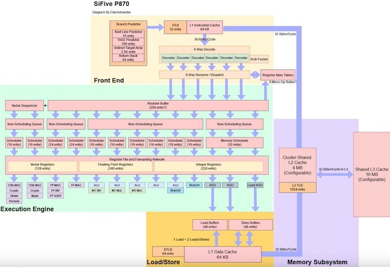

3. Arteris Partners With SiFive for RISC-V SoC IP
Arteris announced the addition of the SiFive P870-D RISC-V CPU to its system-on-chip (SoC) IP library. The pre-verified solution reduces design risk for data center hardware developers looking to address high-performance application requirements. The Arteris SoC is based on its proprietary scalable cache-coherent network-on-chip (NoC) interconnect IP. The high-speed NoC IP reduces latency between processing units in the SoC. By combining the SiFive RISC-V IP with the Arteris technology, SoC developers have a pre-verified high-performance RISC-V core option.
Pipeline diagram of SiFive's P870
Pipeline diagram of SiFive's P870. Image used courtesy of Chips and Cheese
The Arteris/SiFive offering supports the advanced microcontroller bus architecture (AMBA) coherent hub interface (CHI) protocol. AMBA CHI is an open standard for chip interconnect specifications used by many SoC solutions. SoCs are frequently the scaling arbiter for data center cluster systems. The high-speed AMBA CHI compatible interconnect architecture and RISC-V core bring data center-targeted SoC development to the RISC-V ecosystem. With the built-in support, chip designers have assurance that the end result will have familiarity, compatibility, and interoperability for data center buildouts.
