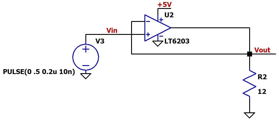

Let’s start with a baseline step response—i.e., what the step response looks like without any buffering transistor or load capacitance. Here is the circuit:
The load resistor was chosen based on the typical maximum output current of the LT6203, namely, 45 mA; the input is a 500 mV step, and (500 mV)/(45 mA) = 11.1 Ω. Here is the plot:
The delay from input to output reflects the op-amp’s slew-rate limitation, and the moderate overshoot is consistent with the fact that the LT6203 has plenty of phase margin at unity gain.

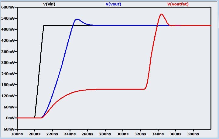

Now let’s insert an FDC2512 NMOS (gate charge = 8 nC) and see what happens.

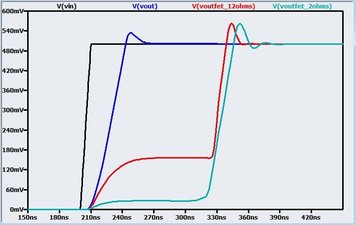

The overshoot amplitude has increased, and we can discern a slight oscillatory tendency. However, this step response is nothing to be concerned about. The next plot shows the effect of reducing the load resistance from 12 Ω to 2 Ω.
We observe some additional oscillatory behavior with the lower load resistance, but the amplitude of the overshoot (about 60 mV, or 12%) indicates that the circuit is still sufficiently stable (12% overshoot corresponds to phase margin of about 57°).

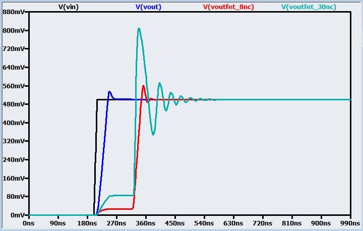

Now let’s change the FET to a part with more gate capacitance. This plot includes results for the FDS5680, which has a gate charge of 30 nC, compared to 8 nC with the FDC2512. The load resistance for both FET circuits is 2 Ω.

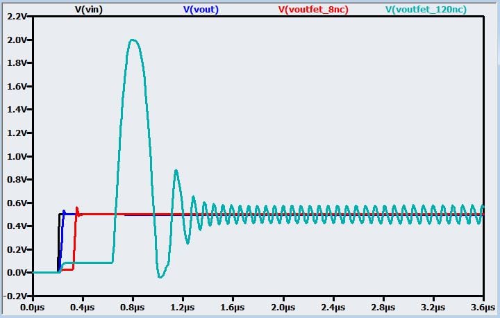

Obviously, we have a problem here. Our overshoot percentage has increased to about 60%, which means that the phase margin is around 15°—not even close to the 45° needed for sufficient stability. Just so we can appreciate the oscillatory vigor produced by a generous dose of load capacitance, here are results for the FDB8030L (gate charge = 120 nC):

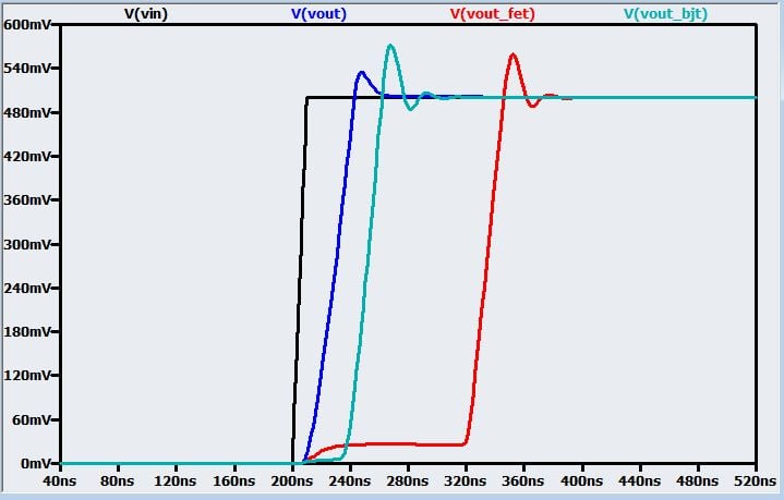

The foregoing demonstration does not mean that FETs are universally worse than BJTs in the context of load-capacitance-induced instability. I admit that I don’t favor MOSFETs when it comes to buffering op-amp output current, and not just because there’s something pleasantly old-fashioned about BJTs. The fact is, I don’t like worrying about stability any more than I have to, and consequently I prefer to avoid the MOSFET’s gate capacitance. However, the above results for the FDC2512 (gate charge = 8 nC) indicate that you can maintain adequate stability by choosing an appropriate part (especially considering that you can get high-current FETs with gate charge well below 8 nC). Furthermore, BJTs bring their own capacitive load in the form of pn-junction capacitance. Take a look at the following plot, which shows results for the FDC2512 FET and the 2SCR293P BJT (both with RLOAD = 2 Ω).
We can see that the BJT’s effect on stability is by no means negligible; actually, the overshoot in the BJT trace is slightly worse than that in the FET trace.
