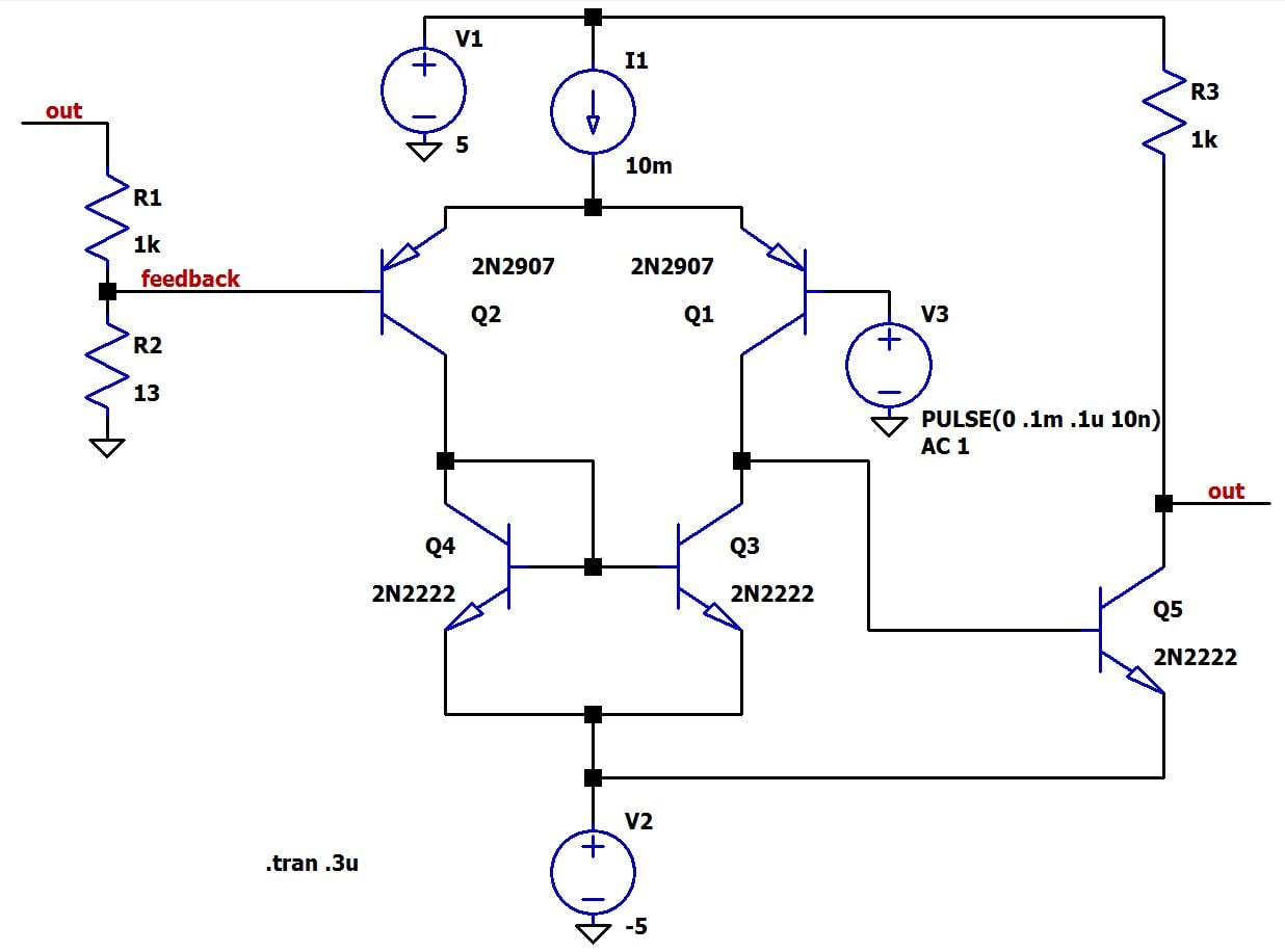

The simple (and highly unstable!) BJT amplifier that we introduced in Part 5 will provide fast, accurate transient simulations. Here is the circuit diagram:
Note that the feedback node is now connected to the base of Q2. Before, we grounded the base of Q2 because we were measuring the open-loop gain (separated from the feedback network), and then we plotted Aβ mathematically—i.e., we told LTSpice to multiply the open-loop response by the feedback factor and plot the result.

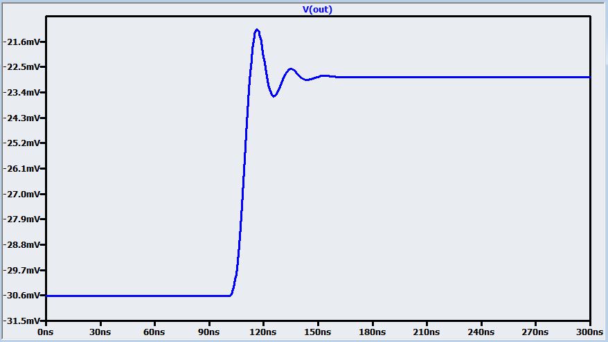

Our goal with these transient simulations is to flood the amplifier with a variety of high-frequency signals so we can see if any of them will coax the circuit into oscillation. This is actually much simpler than it sounds: all we need is a rapid change from one steady voltage to another. The Fourier transform of a step function tells us that a pulse with a rapid rising edge will contain at least a small amount of energy up to very high frequencies. Thus, applying an approximation of a step function allows us to stir up any oscillations to which the circuit might be susceptible. In these simulations we use a 100 µV input step with a rise time of 10 ns. Let’s take a look at the step response for the feedback network shown above, which corresponds to β = 0.013 and phase margin = 45°.
The first thing to notice is that this sufficiently stable amplifier is by no means free of overshoot. A phase margin of 45° does not mean that the step response will perfectly reproduce the input signal. Actually, there is always a compromise between response time and overshoot—this is simply the nature of negative feedback. If you make β small enough to eliminate all overshoot, you end up with a system that takes too long to settle on the final value, as demonstrated in the following plot:

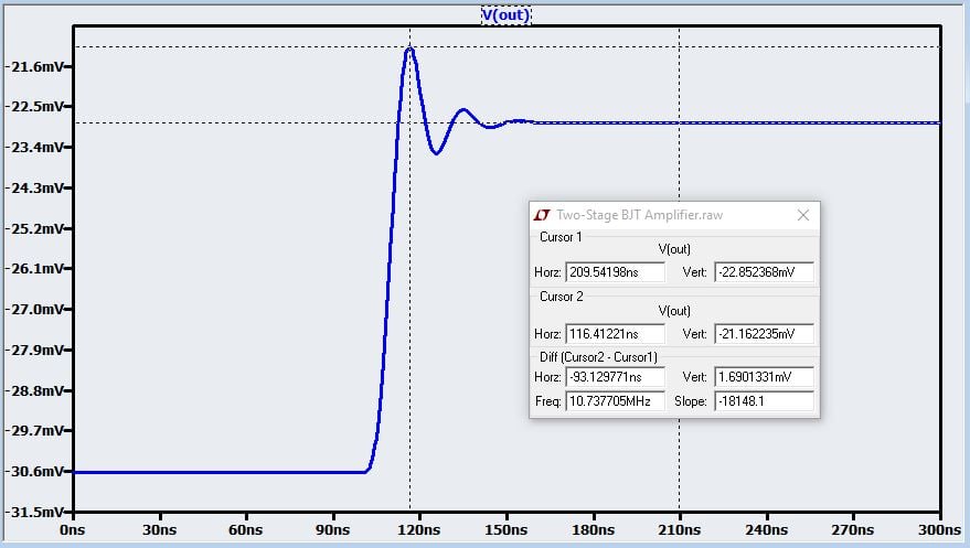

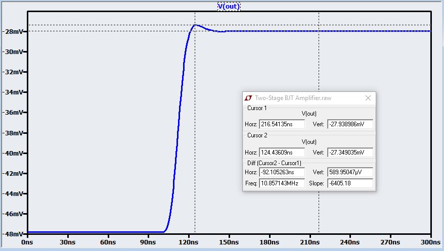

It is possible to derive a mathematical relationship between phase margin and overshoot percentage, where the latter is calculated as (Vpeak – Vfinal)/(Vfinal – Vinitial). This is a very useful thing, because it allows us to determine a circuit’s approximate degree of stability with nothing more than the measured or simulated step response. The following plots show our BJT amplifier’s step response as β increases. The caption beneath each plot indicates the phase margin (obtained from separate frequency-domain simulations), the theoretical overshoot percentage for this phase margin, and the measured overshoot percentage. (Page 17 of this app note from Texas Instruments has a graph that you can use to find the expected overshoot for a particular phase margin, or vice versa.)
phase margin: 70°; theoretical overshoot: ~2.5%; measured overshoot: 3%
phase margin: 45°; theoretical overshoot: ~23%; measured overshoot: 22%

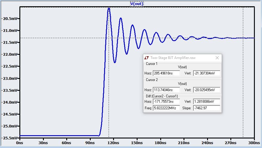

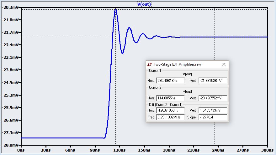

phase margin: 35°; theoretical overshoot: ~33%; measured overshoot: 27%
phase margin: 25°; theoretical overshoot: ~47%; measured overshoot: 31%

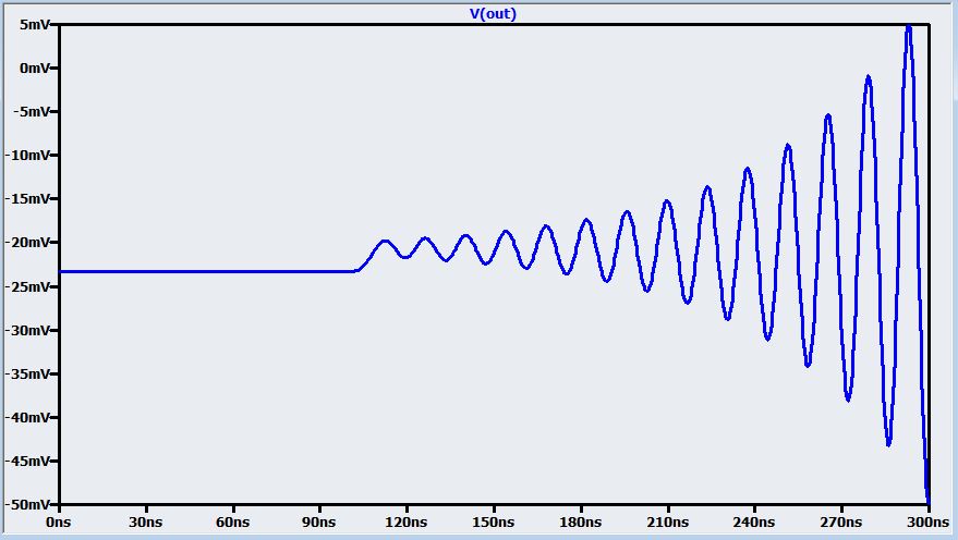

β too high; amplifier not stable
We can see that the measured results are consistent with theoretical results for higher phase margins. Agreement between theory and simulation appears to deteriorate as the phase margin decreases, perhaps because the transient response is affected by some sort of nonlinearity as the circuit approaches instability. But this does not significantly diminish the value of analyzing step response, because the lower phase margins are not particularly relevant for practical design purposes—almost any negative-feedback amplifier needs to have phase margin greater than 35°.
