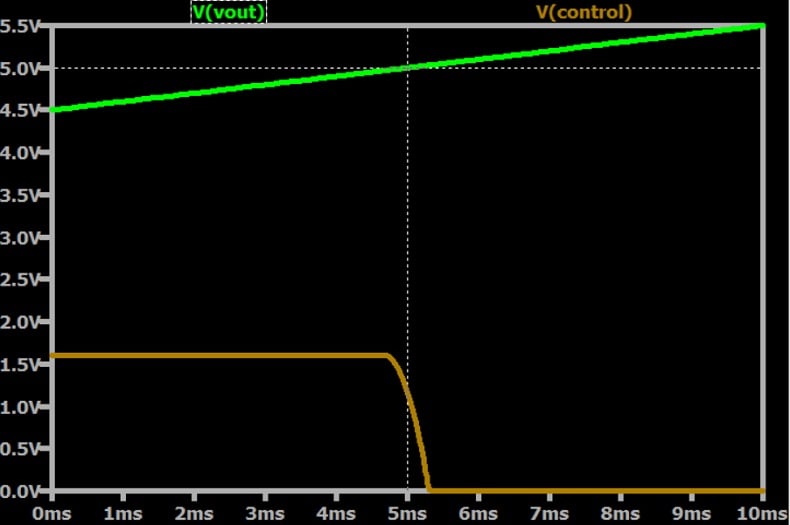

For slow output variations that cause VOUT to drift away from VREF, the amplifier is an inverting comparator. Starting at the left side of Figure 3, when VOUT is less than about 5.0 V, (and VFB < 1.215), the control signal (VCONTROL) is high. At about 5 ms, VOUT exceeds 5.0V (and VFB > 1.215), and VCONTROL switches to low.
Note that the signal labels in Figure 3 follow those in the complete schematic: VOUT is the output of the regulator, not of the amplifier. In accordance with the terminology commonly used in CMC diagrams, the amplifier output is labeled as VCONTROL.
Simulated regulator and amplifier behavior at low frequency for the CMC buck converter under discussion.
Figure 3. Regulator and amplifier behavior at a low frequency.
